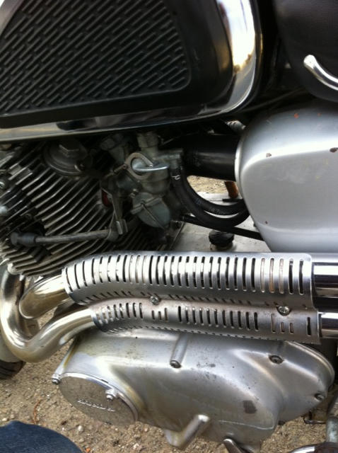

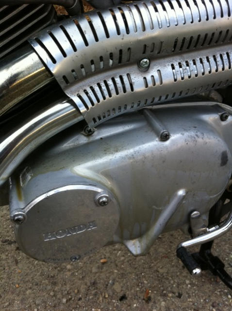

i was riding around 40 miles. It was riding fine and nice and all. When i first started it, it couldn't idle and when i would set it to idle she would just die out and i had to kick start it because my battery was being ran down. I ran her around 20 miles, and after she warmed up she could idle all day. The next day i started her in the morning. Same thing on the idling. I had to really give it gas when i was going to start it up. when she warmed up she was fine. i was around 16 miles on the road today and she started to just have no power. I was in 4th gear, and it felt as if it was running only on one piston. So i down shifted and still no power. i popped the clutch in and the moment the PRM would idle she just shot dead right there. I got off and inspected the bike and noticed the oil all over the side of the motor.

That oil leak is item #2 and I hope it turns out not to be the source of problem #1. You need to determine where it was coming from and that's often hard on a motor that was running up the street because oil blows and drips all over the place.

I realized that my oil is a bit cloudy, and it smells like gasoline. I've concluded that i need to figure out how to clean my petcock. I also bet that my carbs are all screwed up.
I performed a compression test. my left side carb tested at 8.8 kg and right was 8.5. so I have compression above standard spec. This is great! So i am assuming that this whole ordeal is because of carburetor issues. So, i need to figure out what the heck is wrong with my carbs. Is there a rebuild kit available for these guys? I also read up on changing the carbs over to Amals but i couldn't figure out the reason for people doing this/where to get them.
I took off my scrambler headers and the right pipe header had a bit of oil leaking from it.... I wasn't too happy about that. Partially, because i didn't know what it meant. I want to get the original pipes/mufflers but i don't know where to buy them other than eBay. I think I might go that route.
I could not find the major oil leak. The bottom of my gasket seal from my top end to the block is still wet. But when oil gets that hot, you can almost never find where it originates... just where it ends up. So knowing that it's a carb issue, where would you look? Or maybe its just from the large amounts of oil/gas level in my crankcase. Overflow maybe? I'm not too worried about it as of yet.
