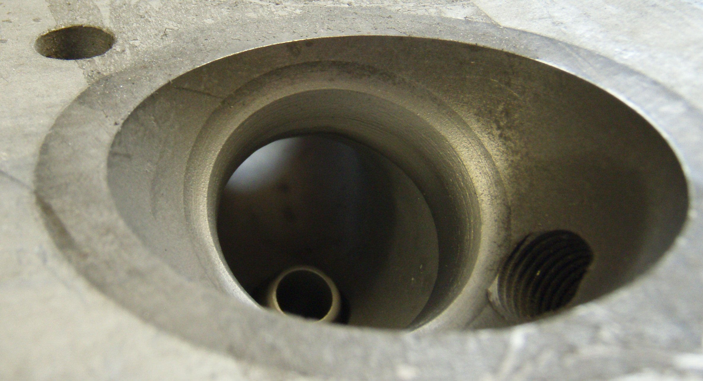

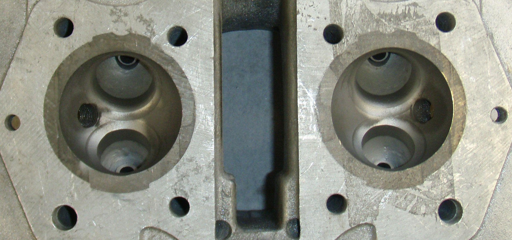

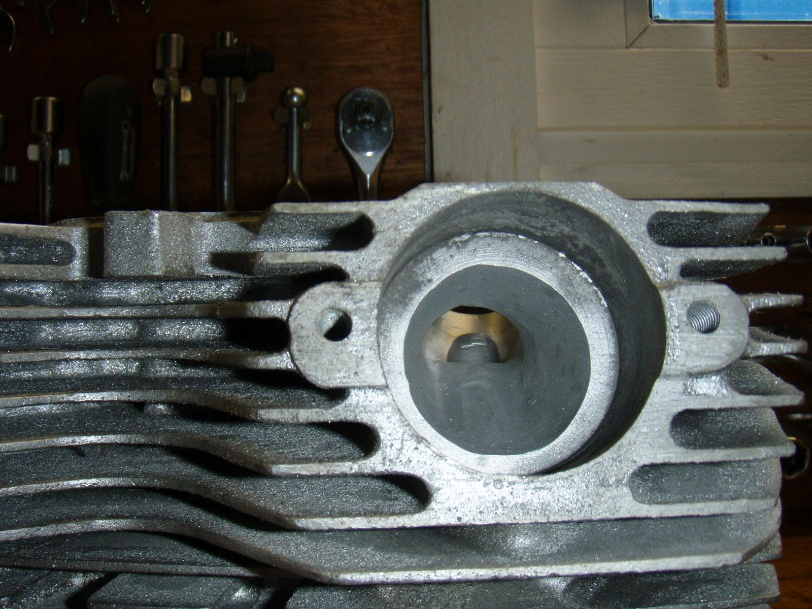

A few weeks ago I started with the head, pictures of what it became are displayed.
I doesn’t seem to be a lot of work, but in this head are more then 4 ours of graining and measuring.
Please compare with a standard head, and see the differences.
