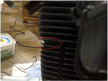

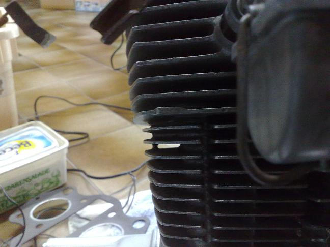

My cylinder was flattened, so that should be ok. I inspected the head, and that one was also ok. I used a steel ruler to check the cylinder and the head, both ok. Than I’ve fitted the head without the gasket and found out that the light is gone!!! So the head and the cylinder are flat – what’s left??? The gasket! I used the same steel ruler to check the head gasket and found out that the surface of the paper and the metal rings are not equal. Of course, if you tighten the head, the gasket should compress and seal the gasket to the head and the gasket to the cylinder. But for some reason, it just does not do it, resulting in oil leakage between the cylinder / head and the gasket. It’s only a hair thick, but it’s enough to let the oil pass.

How flat are the cylinder and head ? Checked with a steel ruler, they are flat. The cylinder was flattend and if you lay the head on the cylinder, it touches everywhere (no more light at the light spot). See picture.

strikef1: I looked at my shop manual to see if there was anything I was missing - no help - also, went into my garage and held a light to my '66 CB77; I could see the gasket neatly sandwiched between the head and block; no light seeped through.
Hope a new gasket solves the problem (the one in your recent photo looks good). If it doesn't and the "O" rings are the correct size, then the head and/or block are not square and need to be resurfaced. One or the other, or both may be warped or contain some other inperfection, albeit too little for you to detect with a steel ruler
A couple more questions: Did you check engine compression? Did you torque the head down in the second photo (with no gasket) or was it merely resting on the block?
