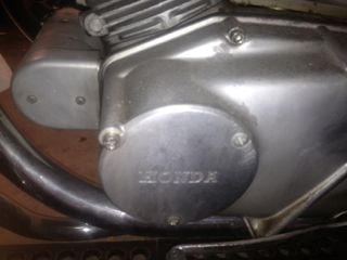

Looks like a good supply but I don't see hex head bolts. Witch screw is the "long fiter screw" I was sure that I got all of the covers screws. Now I wonder if I am missing one LOL. A photo of this screw on the bike would help.

Flutetears, I'm assuming Brewsky is talking about the long panhead screw that holds the oil filter cover on the l/case, if so, here is a source.
http://www.hondapartsnow.com/genuine/ho ... 06115.html

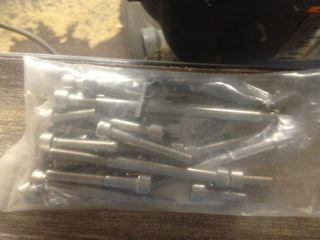

Post by FluteTears » Fri Dec 14, 2012 10:13 am
This is the bolt kit I got note the WEB site is not up maybe try the phone number on the card.
Brewsky is the bolt you say is missing from most sets?

Post by brewsky » Fri Dec 14, 2012 1:19 pm
Tinman wrote:Flutetears, I'm assuming Brewsky is talking about the long panhead screw that holds the oil filter cover on the l/case, if so, here is a source.
Tinman
I think if you actually try to buy it, you will get an answer that it is no longer available.
At least that is what happened to me....several times.
That same screw is actually used on some Honda Acura models, and I was told it was available, paid for it at a Honda car dealer, only to be told the next day it was out of production.
