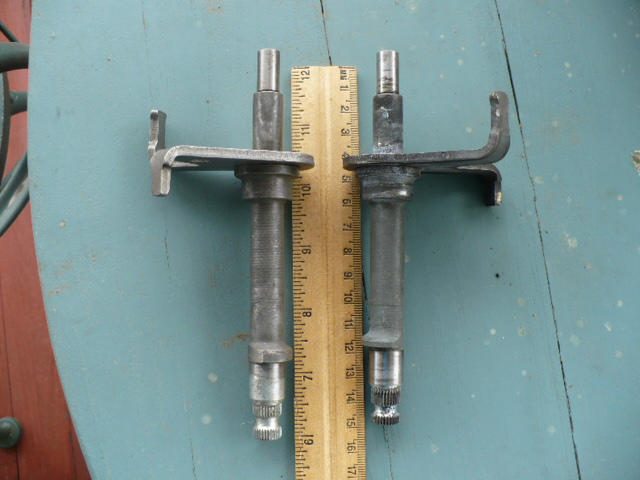

I got everything off, cleaned oil filter, clutch plates, ect. Put the shifter shaft in (no problem) and started putting the side cover back on. I kept trying, tapping here and there, pushing on the exhaust pipe thinking it was in the way. Just couldn't get the cover to go all the way down. Got to looking at the old shaft and compared it to the new....yep, it's about a 1/4" longer. My model # is CA77E-1021938. Was there a change in there somewhere or did I just get the wrong shaft? I'm a little frustrated right now.

Post by Hoosier Tom » Wed Jun 06, 2012 11:32 pm
You have an early gear shift spindle, 24610-259-020, which is longer than what you need, part 24610-259-030. The -020 was used on very early 250/305 Dreams.
HT
shift spindles, early one on left

Post by rzgkane » Thu Jun 07, 2012 10:37 am
There's always a catch! Does that mean that the early clutch cover was deeper than the late style?
I just checked and I have a shaft the size you need. (save the jokes)
IMG_0956 by rzgkane, on Flickr
Hoosier Tom wrote:You have an early gear shift spindle, 24610-259-020, which is longer than what you need, part 24610-259-030. The -020 was used on very early 250/305 Dreams.
