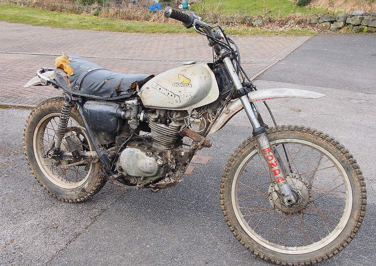

I just 'burdened' myself with a very sorry looking XL250 Motosport........
