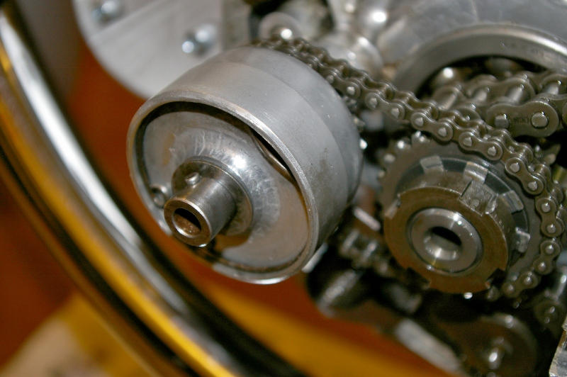

Missing Washer between Oil Filter & Lower Crank Case?
Wilf
Posts: 395
Location: Gibsons, BC Canada
Post by Wilf » Mon Dec 20, 2010 2:56 pm
Many members have asked this question so I've attached a photo showing what I believe to be the correct location of the washer--between the outside filter cover and the indexing pin.
Wilf
