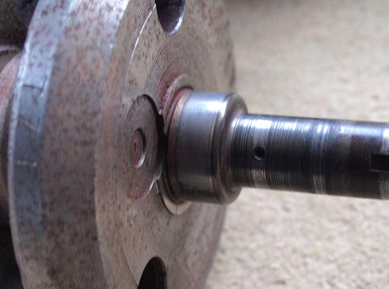

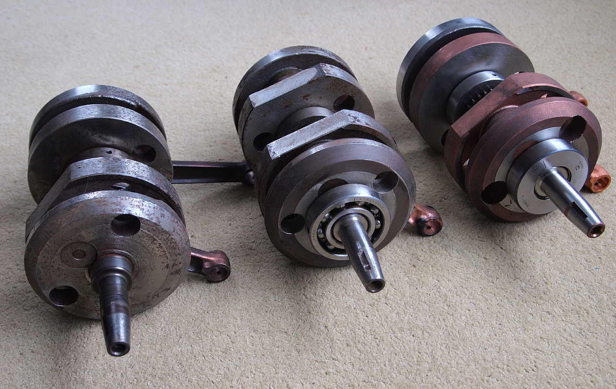

Thanks for nudging us along here. I realise now that it's not just the small hole in the tapered shaft but a drilling through from the inner end (crank web) that lets the oil through. The con rod on my CB77 crank is rusted solid and covering that hole. I understand how the oil gets in now - apologies for not seeing that earlier. I was struggling to understand how the oil got inside the shaft to come out.
I have attached a pic or two of the three cranks I have to hand. Not only are the hole sizes different (and smaller mains on the 360 crank - early(?) )but the flats on the crank webs are different too, and not particularly consistent with the hole size.
With a quick measurement I have
CB77 Hole 20.67 mm Flat 63.5 mm
C(A)72 Hole 19.17 Flat 68.0mm
CL77 Hole 23.3 Flat 62.4
Looks like I have to do quite a bit of work to convert CL77 to CB77......
CB77 shaft with hole size 20.67, Flats 63.5
From left CB77, C72, CL77
