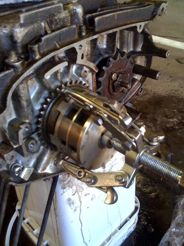

Does anyone have pictures on how to remove the rotor? I can't figure it out for the life of me.

Post by kyle91987 » Mon May 24, 2010 6:18 pm
Something tells me that this isn't what you all were talking about. Any help will be greatly appreciated.

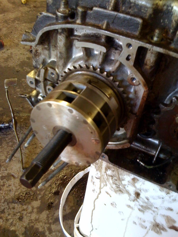

Post by kyle91987 » Mon May 24, 2010 6:37 pm
Or is this is correct? I'm sorry I just don't want to be unsure of what I have to do. The Clymer's and Bill Silver's guide are a little vague. So I just turn it clockwise and the rotor should come out?

Post by busaken » Mon May 24, 2010 7:40 pm
kyle91987 wrote:Image
yes clockwise and it will come out
Post by LOUD MOUSE » Mon May 24, 2010 9:53 pm
Most time ya will need to turn the tool till really tight then hit the end of the tool with a soft head (brass/plastic) hammer to shock the rotor off the shaft. ..............lm
