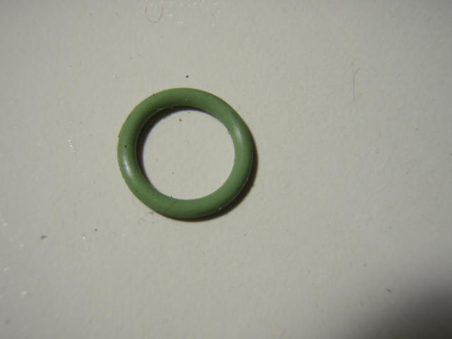

yesterday I looked through a few NOS head gasket sets from Honda and other makes (all for CB72)
I have at least 3 different Honda head gasket sets and within two sets 268-020 and 268-030 I discovered a few different items, also the O-rings. in the 020 set these rings are black, and in the 030 set these are green.
just letting you know that also Honda had more then one type O-ring, but not a change in part number of this O-ring and that's making me curious. The green material seems more elastic to me than the black ones.
I always used the green ones, and no problems (without using bond) ever.
(if anyone wants I can post pictures of the different O-rings)
jensen
jensen
Posts: 1143
Location: netherlands, huizen
Post by jensen » Mon Sep 07, 2009 2:13 pm
I measured both O-rings, the black ones (0611-268-020) measure 14.8 mm O.D, and diameter 1.95 mm. The green ones (from 0611-268-030) measure 15.0 and have a diameter 2.1 mm. The green one is softer than the black one.
My part manual says p/n 91303-259-000, size 11 mm I.D. with diameter 2.0 mm.
as far as I know only one part number exists, and that's this one, but like I stated in my previous mail, it are two different parts (color and size)
It may seem that the difference is to small to mention, and maybe that is the case.
