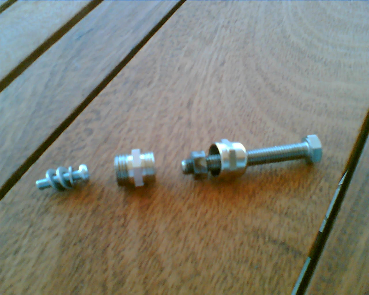

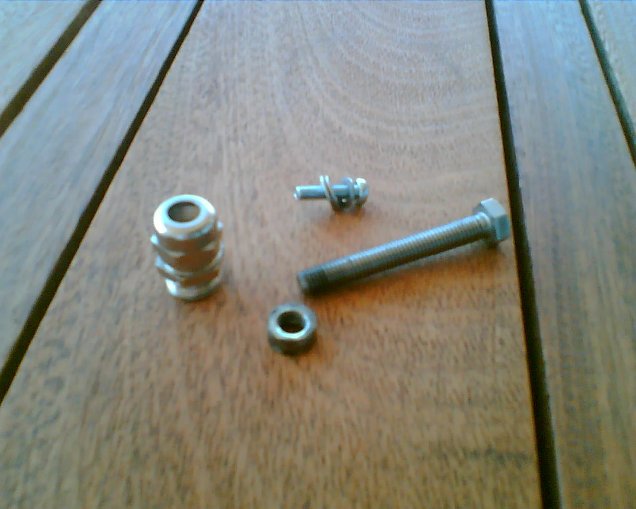

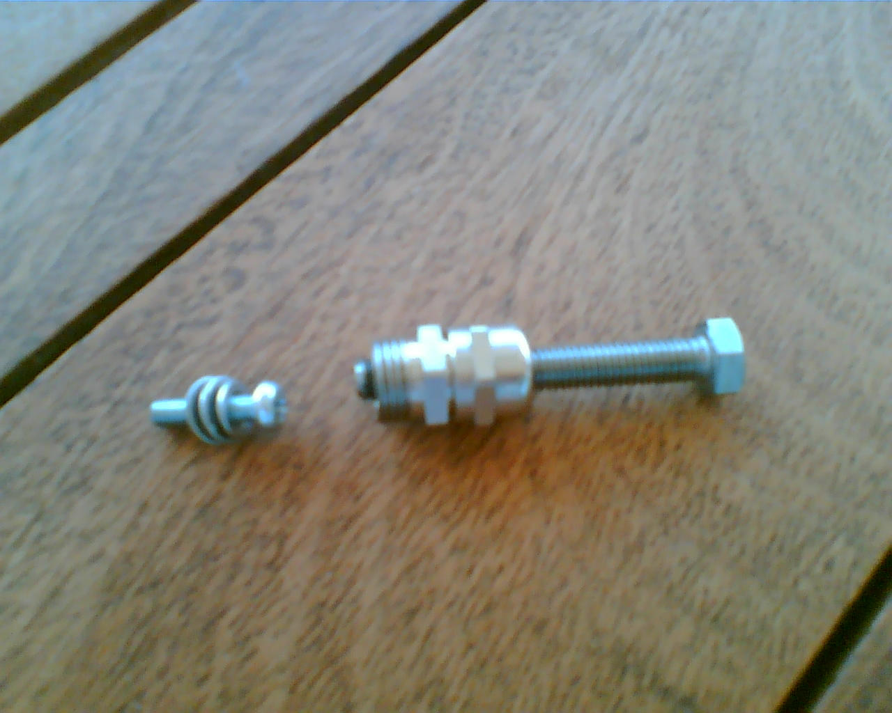

The actual thread is PG9, which is an electrical thread used in cable glands and entries. I made a puller in the end (as Ed at Western Hills Honda didn't bother replying to my request for availability of a puller!) using a plated brass PG9 gland (with the sealing parts removed), an M8 x 80 machine screw -- although a 50mm should suffice, an M8 plain nut with the peaks ground off and an M5 stainless steel screw with 1 x M5 and 2 x M6 washers. Better to use a cap-head (Allen socket-head) rather than the type in my pics!
Method:
Take the skintop cap off the gland, insert the 80mm screw and run the nut on a bit so that it ends up inside the gland ass'y. Screw the cap back back onto the inverted gland body (the thread is shorter on the mounting end, so use the skintop end to insert into the rotor).
Place the M5 & M6 washers on the M5 screw and insert same into the crankshaft's M8 threaded centre so that the larger washers seat against the crank end; 2 or 3 washers will reduce any 'cupping'
Screw the gland body into the rotor and bottom-out the thread to ensure maximum load-spread
Wind the M8 screw in against the M5 head as tight as possible using a socket or spaniard.... sorry, spanner, whilst holding the rotor by hand
Give the screw-head a sharp tap with a heavy hammer and the rotor should just POP off the taper
NOTE: Don't whelt the crap out of the bloody screw head enough to damage it -- a sharp, assertive tap should suffice. If it doesn't budge, then hold the rotor and tighten the screw some more, repeating the process. I actually tightened mine after stopping the rotor moving by holding an inserted 3/8"-drive socket extension in one of the magnet spacings, but I wouldn't countenance this manoeuver for fear of someone damaging their rotor irrepairably.
If this fails then your rotor's either corroded or beyond this inexpensive method; buy a puller!
Regards,
Steve
