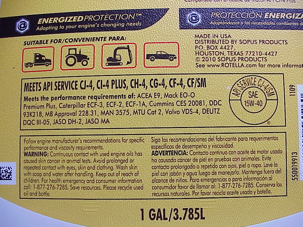

I think you are confusing MB specs with a JASO MB rating. They are not the same. Rotella T 15W-40 has on it's label, in addtion to several other specs, MB 228.31. The MB in this case stands for Mercedes-Benz and is one of their diesel specs. That same label also says JASO MA, which is the correct JASO rating for motorcycle use. I've attached a pic of the Rotella T label here.
The T-5 has a similar label and also meets the same MB spec. But, there is no mention of meeting the JASO spec which is why I left it on the shelf. There was no 5W-40 there.
I was a bit confused at teh store because I had thought that the JASO MA rated syn was 5W-40 bit all I found was 10W-30 and without a JASO MA rating. It only has the JASO DH-2 rating. At the time, I thought that perhaps somebody had miss-typed it or I was not remembering correctly. Appreciate the clarification on that point.
Here is the link to the Rotella website listing their products. If you click on the icons, it will bring up the spec for each oil. http://www.shell.com/home/Framework?sit ... _home.html
On this site you will also see that the Rotella T Triple Protection and the T6 5W-40 are both JASO MA rated.

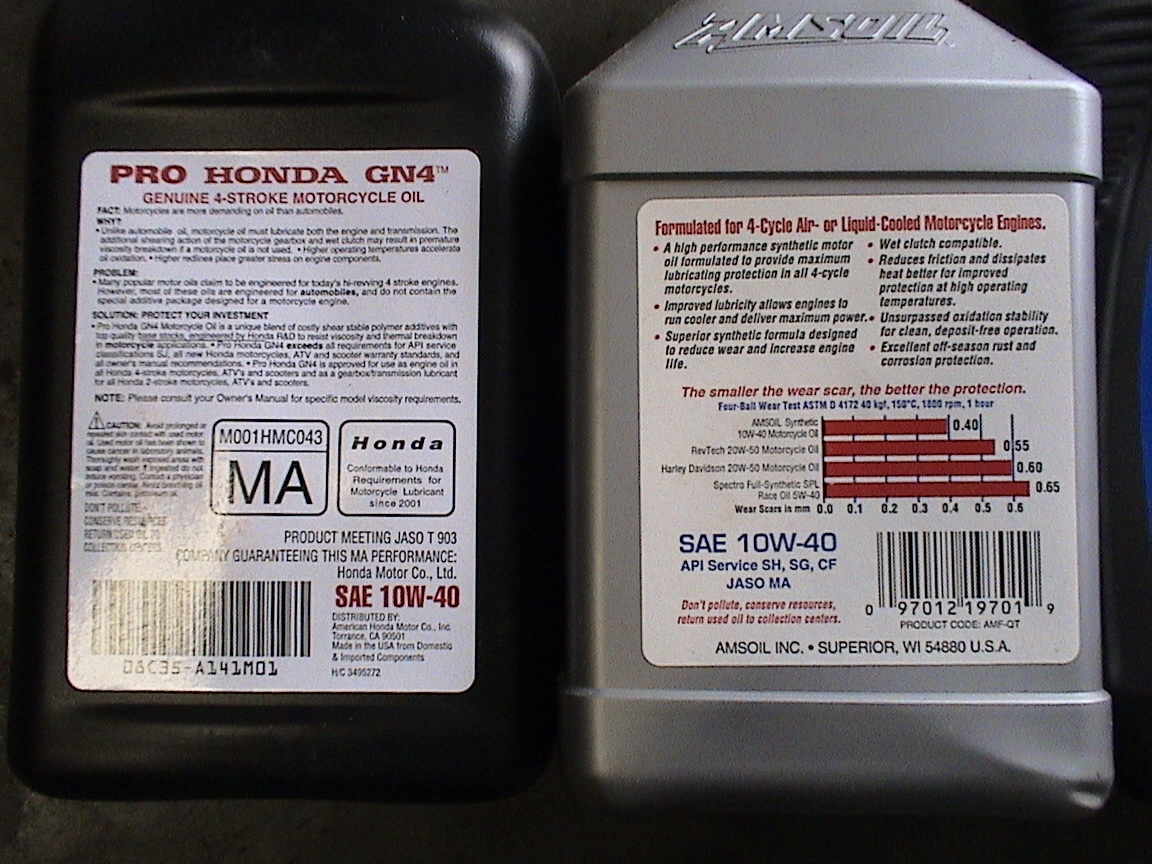

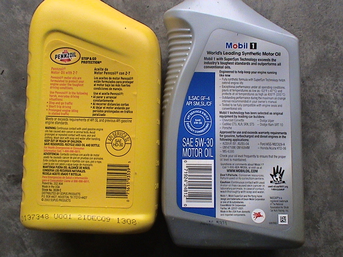

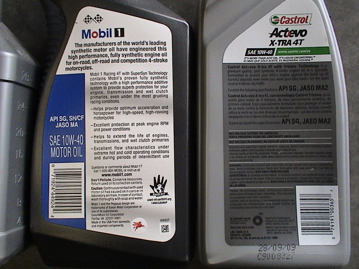

Some label examples, from what was laying around the garage:
