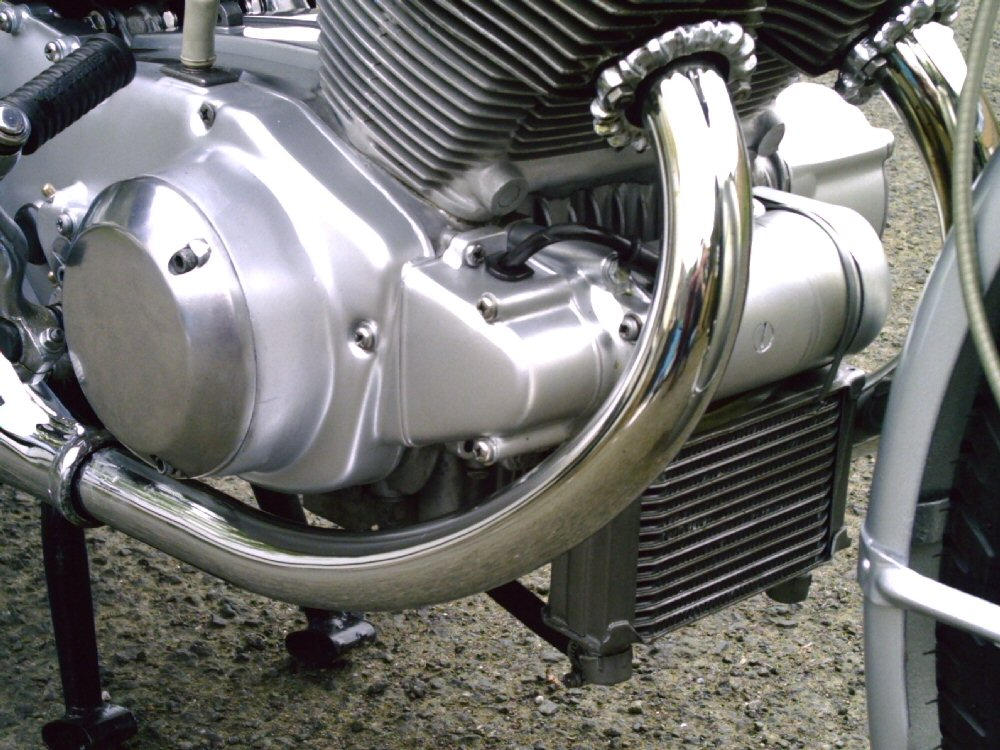

I'm sure he did a great job of banging the nails in, but that cooler is just too tall to be aesthetically-pleasing. That's also the bike with the 110 MegaWatt alternator from the Moto Guzzi. Thanks for that document too.
Now I've said I don't like his cooler I'm going to make a right pig's arse of mine when I hammer it into place, and then you're all going to laugh at me........¦-((

Hi,
I don't intend to shake things up, but I think an oil cooler isn't necessary on these bikes, but I have to admit, this is from my point of view in the Netherlands with a very moderate climate.
Only excessive speeds during long highway trips in the summer heat will maybe demand for an oil cooler. The worst thing that happens is that oil loses it's lubricating capability, but as I stated earlier in this thread, changing the oil often, and using good oil will prevent that from happening.

Or possibly long periods of idling in traffic in summer heat? That's my viewpoint and, at times, my riding habit; traffic, narrow one-way streets, no room to move past safely, up to 40ºC ambient temperatures and sometimes 20 minutes wait before managing to even achieve walking pace. Hence my rationale.jensen wrote:Hi,
