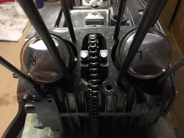

Good evening everyone,
Could someone please look at the attached picture and tell me if I am missing a knock pin in the open port seen to the right of the cam chain. Looks like an oil port to me but want to make sure it is meant to remain open as shown.
Thanks and Merry Christmas!!
Mrburnn

Mrburnn
That feeds oil from the oil pump into the the cross channel at the front of the barrel and thence to the top end and right crankshaft bearing.
No knock pin required but a good, flat gasket surface is essential on both crankcase and barrel.

Post by LOUD MOUSE » Tue Dec 19, 2017 7:56 am
Do you have the ones at the outside of each piston?. ...................lm

Post by Mrburnn » Tue Dec 19, 2017 9:11 am
Hi Loud Mouse, thanks for taking the time to review my post! If you are referring to the locating pins shown in this picture then yes I do.
Happy Holidays!
Mrburnn
Post by LOUD MOUSE » Tue Dec 19, 2017 9:55 am
Thank you.
Those are the ones. ...........................lm
