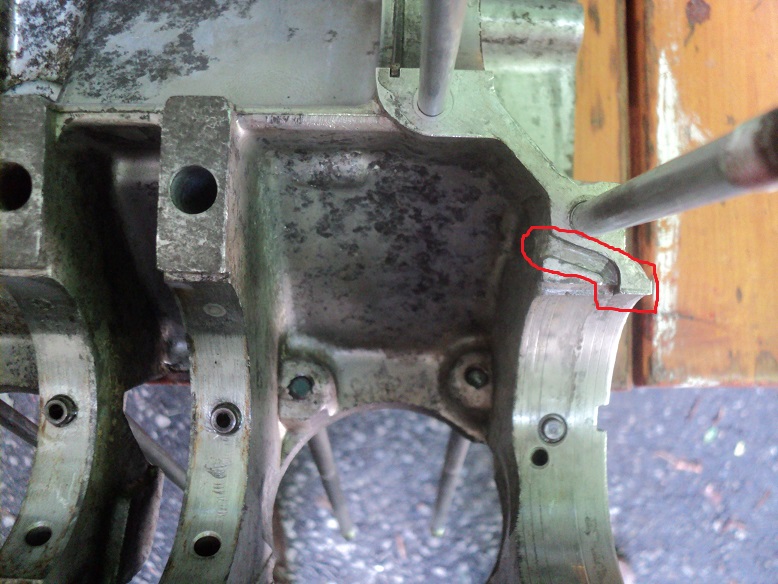

Top crankcase half upside down, right side -
This appears to be an oil passageway, how tricky is it to put crankcase sealer here?
oil passage 002.JPG (183.39 KiB) Viewed 2532 times

Put it on the lower case. .............lm

Post by R100 » Thu Aug 20, 2015 3:36 pm
LOUD MOUSE wrote:Put it on the lower case. .............lm
R100 wrote:Top crankcase half upside down, right side -
Thanks LM.
Do you do all the crankcase sealer on the lower case?
Any pitfalls in doing it that way?

I do apply the sealer (HONDABOND 4) to the lower case and be sure to put some at the 2 studs which are in the middle. ...................lm

Got it, thanks.
