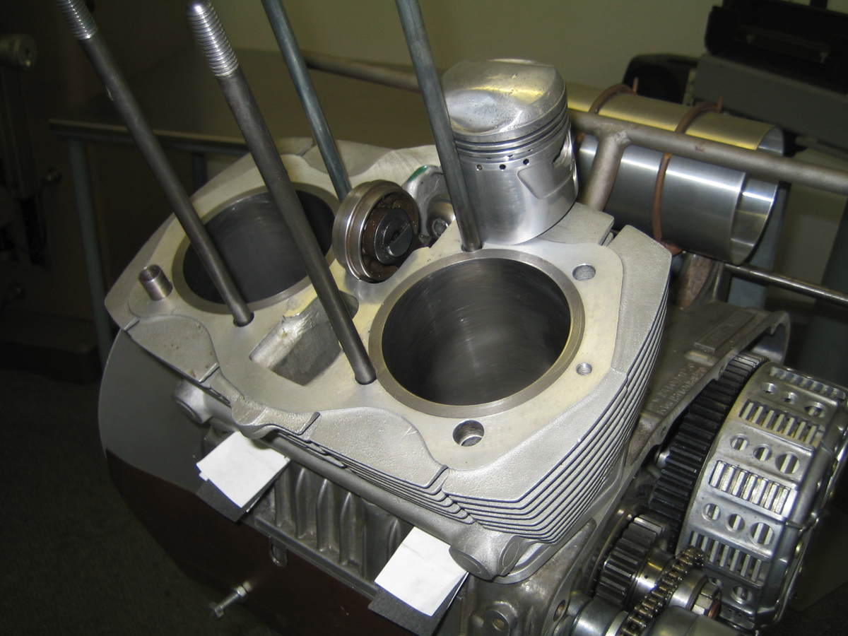

You could try pushing out to 500cc..... :-)
500cc CB72.jpg (122.63 KiB) Viewed 5623 times

Post by MBellRacing » Tue May 12, 2015 7:25 am

Post by LOUD MOUSE » Tue May 12, 2015 7:55 am
I know of a feller who uses CB450 crank.
See the gear driven clutch?
Compare piston to bore size!
Notice web added between the cylinders?. ...................lm
MBellRacing wrote:So I sense some sarcasm, but after watching some videos of people running 500cc CB77s, I am curious what it takes. Same crank?
