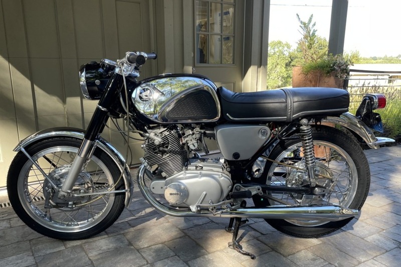

My 64 CB77 is stuck tight, likely rusted in place as the previous owner had not stored it properly. So when I pull the engine down I plan to do upgrades to increase the reliability (sure its a Honda, but it IS a 64 Honda), and up the power reasonably. Electronic ignition. Better valve springs. Over bore to 350cc? Bit of carb tuning for easier starting and warm up (typical cold blooded Honda?). My only previous Honda experience are the other Hondas I've owned/own over the years: 74 CB350F, 78 CB750K, 80 CB900 Custom, 83 XL600, and 80 XR200 (not running yet).
My plans for my 64 CB77 are some mild visual changes; low handlebar with a bar end mirror, and Akront polished rims. Goal is to achieve a look like this beauty:
