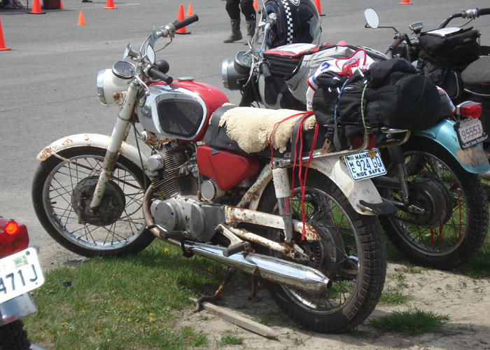

I had the same trouble on my cb160=bought non running, think it hadn't run in many years.  As a matter of fact it looked like it had been stored underwater.  I call it "the patina special".
Check your valves. Mine were too tight and it wouldn't run hardly at all. I didn't understand it at the time, but your valve adjustment effects the timing too.
Then, clean your carbs at least a couple more times. I had pieces of crap under the needle valve seat where the gas comes into the carb. Didn't see them but if I had turned the carb over they would have fallen out.
Check you timing, points condensor and coill. I ended up replacing my coil and it ran much better. Originals are hard to find, I used a harley sportster points coil, had to make a bracket to mount it to the horn mount.
It still doesn't run great, but I did complete one day of the Moto Giro East event on it a few weeks ago.
Oh, try the plug from the side that fires in the other side. I have had several plugs that were bad out of the box, sparking to the side of the plug instead of the electrode. Also be sure they are gapped correctly. They are not correct out of the box.
This can drive you crazy. I know from experience.......
