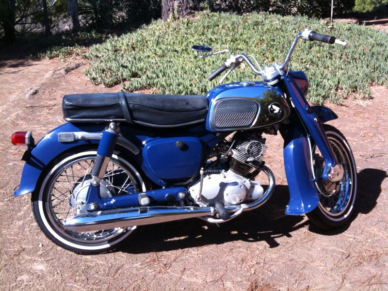

Hi, first post. I just bought an old Honda CA95 from a guy in my neighborhood (orig. owner, only 4,000 miles) and I'm in the process of getting back in the road.
So far, I've done the following, oil change/case flush, new plugs, new batt., new air filter, new tire tubes, pet cock rebuild, clutch plate resurface (they were fused together pretty well)
Anyway, it fired on the first try (I almost fell over I couldn't believe it) but after a short ride around the block, I noticed it only fired on one cylinder. I simply swapped the plugs (re-checked their gap) and the bad cylinder fired fine now (but the other didn't now). I'm going to run out and pick up another plug just in case it a rouge bad NGK, but I suspect it could be something else. Any ideas?
I noticed this bike fires both plugs simultaneously. With no distributor, both plugs are in the same electrical circuit, could it be low voltage from the coil or something?
Also, its smoking pretty badly (out of which ever cylinder is firing) I'm thinking it will need valve seals (not rings) since it went 35+ years in storage and it has such low miles. Are they easily attainable?
Thanks for the help, here's a pic if my new blue "baby".
