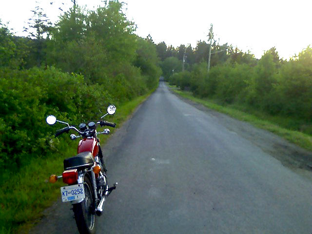

I have a 1975 CB125S, pretty good condition -- 75,000 on it. My first bike and have had a lot of fun repainting its detail work and polishing up the chrome on it. I know a little about mechanics, but not really enough to do much. I was really surprised at how much can be done if you just read the instruction manuel. That being said, it should be established I'm a student -- and plan on being a student for at least another 5 years -- so money is tight and I'd prefer to do tweaks to the bike myself instead of taking it to a mechanic.
