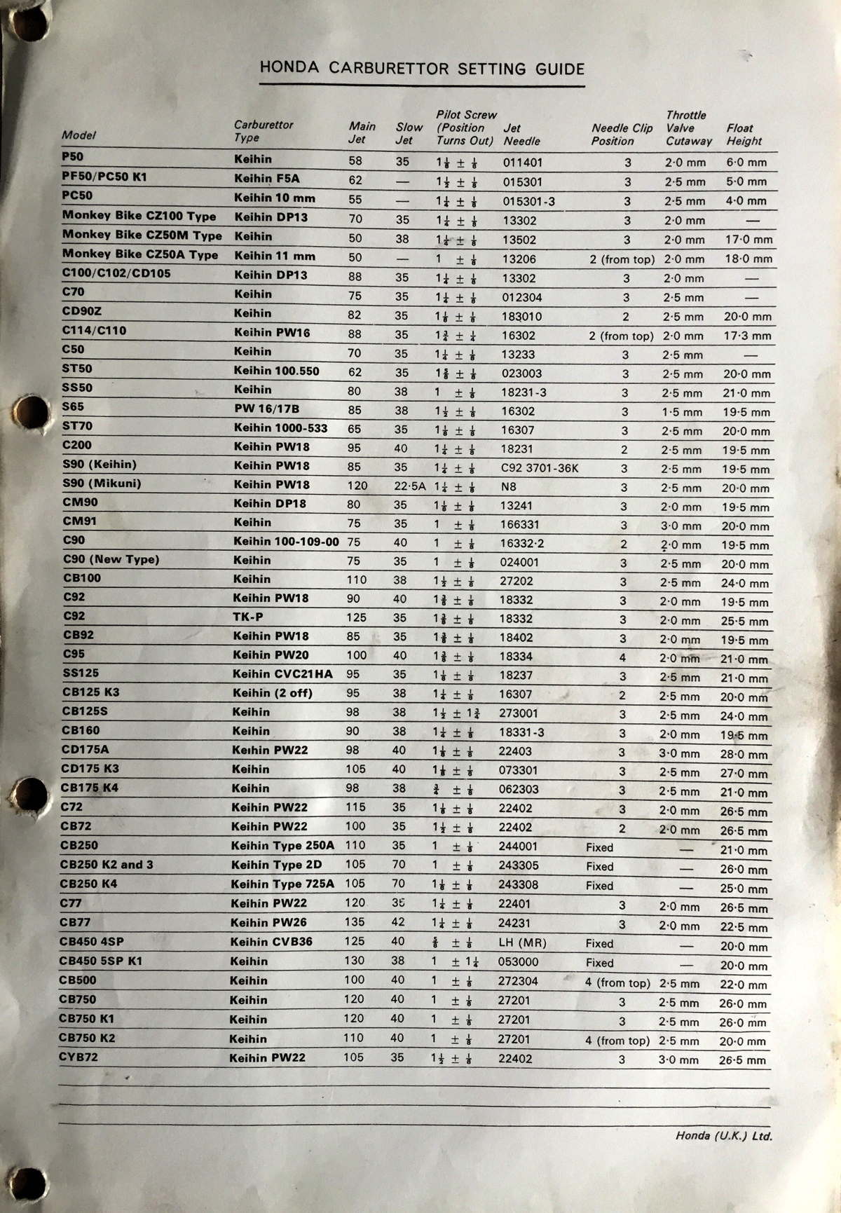

motorboy3 wrote:Any Idea's My bomber starts and idles great but when i take it out for a run and stop at a red light or the like the revs drop to 500rpm and it cuts out(engine stalls)? Also does any one know what are standard numbers for the pilot and slow jet UK bike
Settings small.jpg (324.24 KiB) Viewed 18382 times

G; any way you can post that carb sheet in a printable form? I don't have sheet and it has some handy info
Thanks
Randy
malcolmgb
Posts: 401
Post by malcolmgb » Fri Aug 11, 2017 7:03 pm
rrietman wrote:G; any way you can post that carb sheet in a printable form? I don't have sheet and it has some handy info
Thanks
Randy
It is a picture, just right click on it and save as an image then print out.
