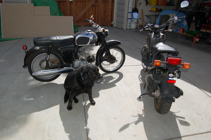

Post by bigolsalmon » Wed Mar 18, 2009 10:43 pm
Hi guys,
I just started restoring my C200 (after being inspired by Paul's incredible resto) and am curious as to the best way to clean some rust out of the gas tank.
I have it completely disassembled but wasn't sure the best way to do it - I have read a couple of methods including muriatic acid solutions with rinsing with a power-washer and a gravel slosh mixing but would like to get some expertise here as this is my first resto.
Thanks in advance!
Bill
Denver, Colorado
My C200 with my helper Molly and my Ruckus

Post by 4shorts » Thu Mar 19, 2009 3:14 am
Hi Bill. First of all welcome to the site and that's a fine looking buddy you have there in the photo. Nice bikes as well.
