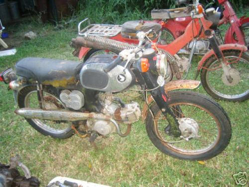

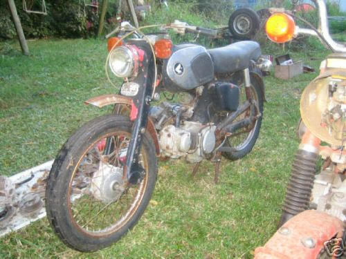

Post by lucky13 » Fri Sep 28, 2007 8:08 am
Here's my C200 at the time i picked it up about 2 months ago along with an early 70's CT90 & a late 70's.
cheers,
glen.
