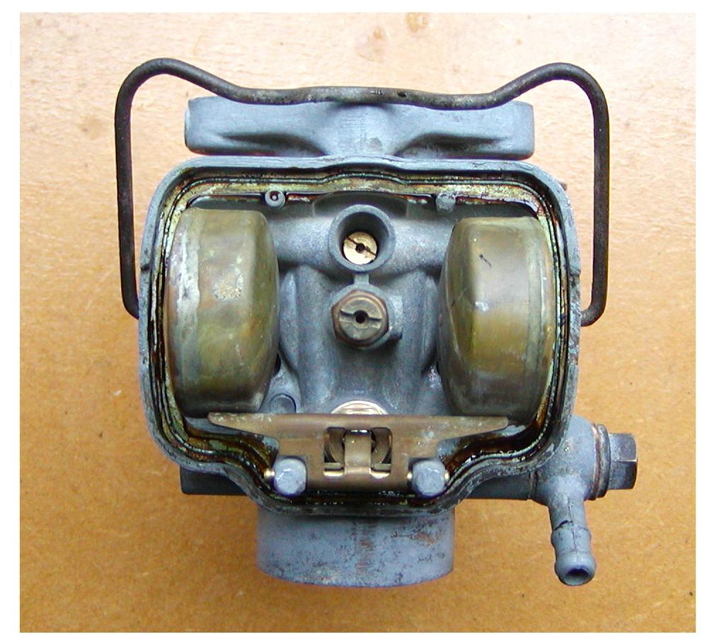

My CB77 is a 1964. The bowls look square but where the gasket sits is curved rather than straight.
Also the corners are round. Is this called square bowl or round bowl?
Photo attached, please ignore Loctite aviation gasket cement, which will be cleaned off later.

I have bought stuff from Sirius before but didn't spot the gaskets. Thank for the heads up, will browse later. Are your bowls the same shape as mine?

Tis a round bowl. ..............lm

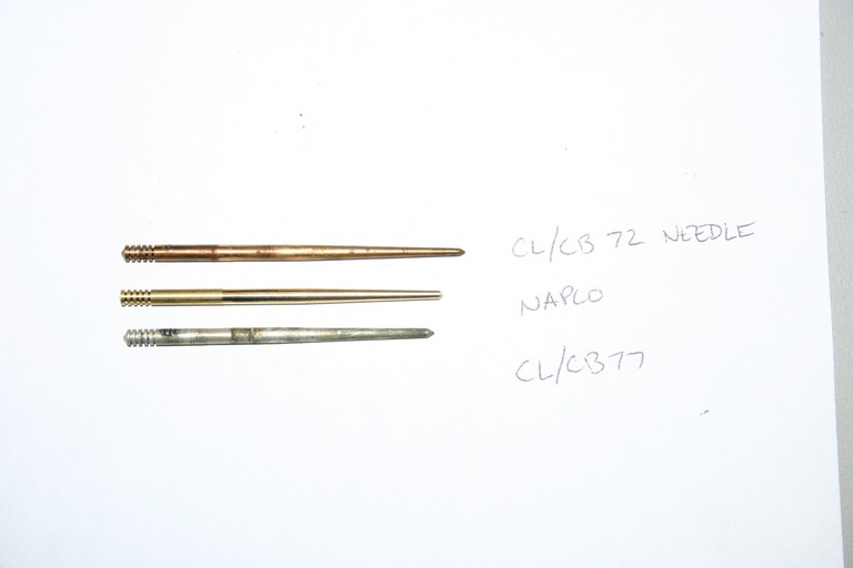

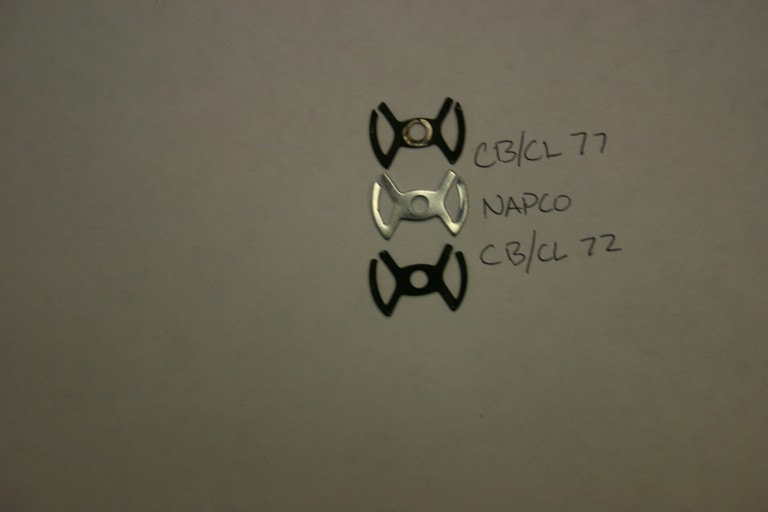

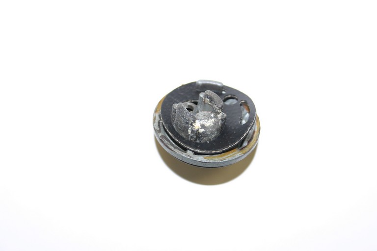

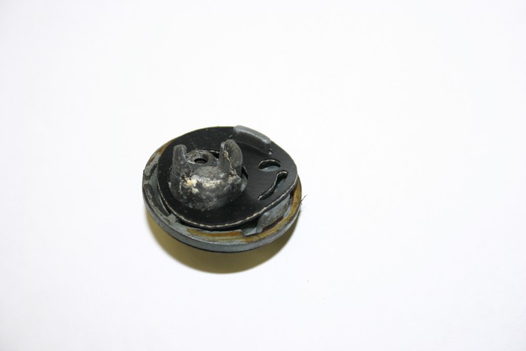

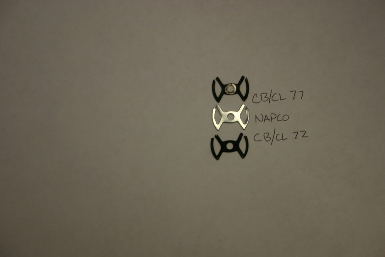

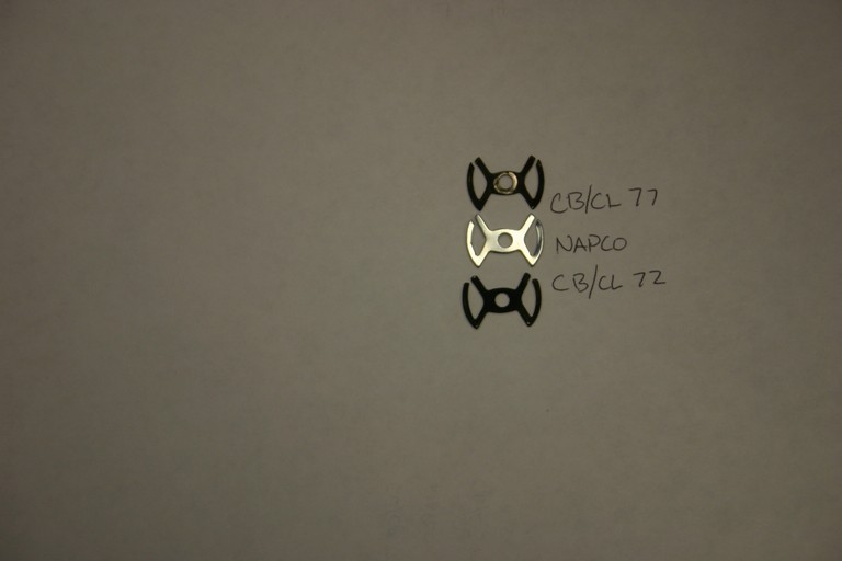

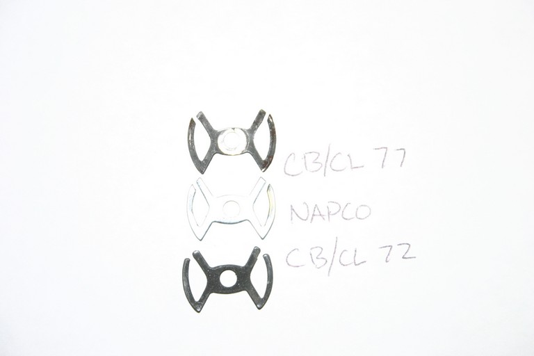

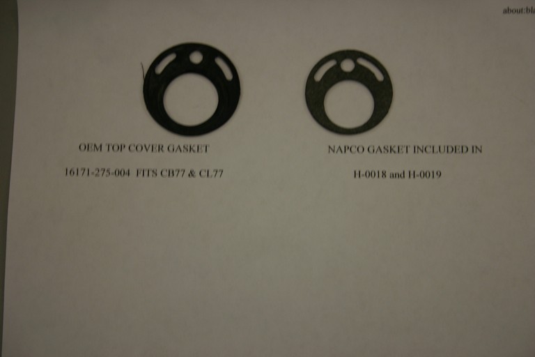

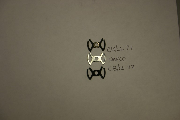

I just stumbled on this thread and wanted to update it with a little information. As the importer we did our best to work with the factory to sort out these issues years ago when they were first discovered. They are not interested in updating the parts to be correct. Our customers were told the item would not longer be imported, but they complained and wanted to keep on selling them as they felt the parts were still useful. We agreed, in hindsight that probably was a mistake. I am sorry for any problems this item has caused. Anyway we're not trying to hide anything here. We have been sharing this information with everyone who orders these since we found out years back. Please see photos attached.
Dubco kits
