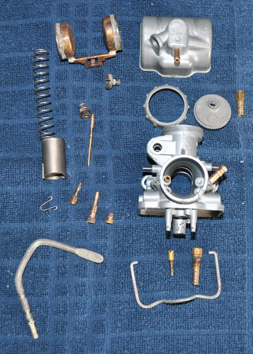

I have a HONDA carb taken from CA77-110130. It is a KEIHIN with 20 on the top cover and a 18mm anodized slide and nylon slide position key rather than steel. I've seen many of these engines however all had 22mm slides. See the pics and tell us what you think it's really installed on when issued. .....lm

LM
Could it be from a CA92 or CA95?. Haven't seen one for a long, long time but the mounting flange looks a little familiar.
I put one of those carbs on my old BSA Bantam when I was 13 or 14........ That's a long time ago. :-)

Post by G-Man » Thu Apr 25, 2013 6:35 pm
Fuel inlet is on the wrong side for those.....

Post by LOUD MOUSE » Thu Apr 25, 2013 6:51 pm
I found a rebuild kit for the 126/160 and 175 from that era.
All parts fit but kit shows different float settings.
I really don't think the 305 came with this carb and am waiting for the owner to remove the spacer and send me a pic of the intake area.
I'd bet the studs have been drilled and tapped to a smaller span. .......lm

Post by G-Man » Thu Apr 25, 2013 7:11 pm
LM
I reckon that it is probably a CB/CL175 left-hand carb with a Dream choke lever....
And the mounting holes drilled...

Post by LOUD MOUSE » Thu Apr 25, 2013 7:19 pm
Not saying ya wrong but this choke arm isn't from a DREAM carb. ............lm

Post by G-Man » Thu Apr 25, 2013 7:22 pm
HaHa! That bit was just a guess!....
