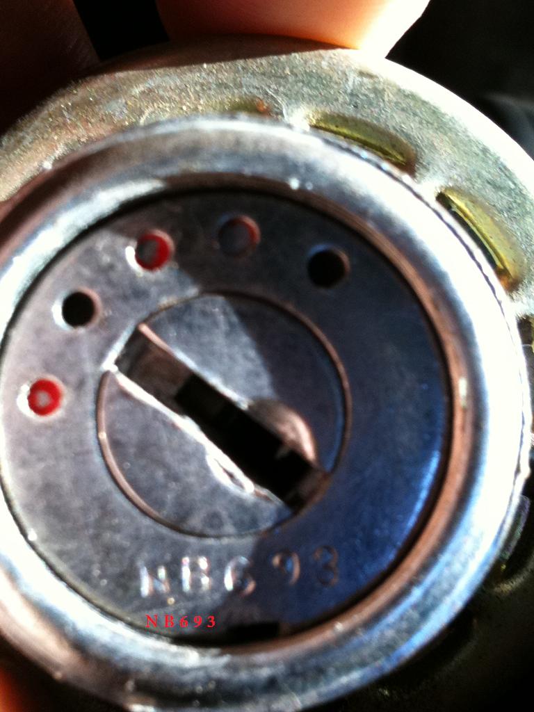

There are several sellers of keys on ebay and some members here have them. Get the number of of your ignition switch and post it here.
Rigentinc on ebay has a lot of Honda keys.

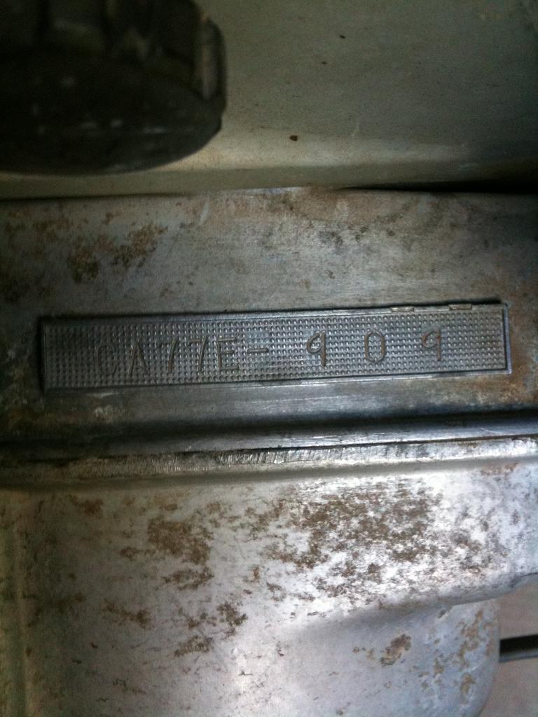

Took a couple more pictures to demonstrate engine# CA77E-909 (is this '63 model engine?)
and main switch # NB693
Got the lock cylinder out and planning to go to one of the oldest key shops in town (doing business since the 60's), I'm being hopeful that they'll have some blanks. I did find some blanks on e-bay...if I can't have them made by Monday, I'll e-bay a set.

CA77E-909
CA77E-909
NB693
NB693

This guy can make you a key from the lock # . Looks like a replacement upper case.

Thanks for the info...going to write up an email, see what happens. Got a little anxious with the main switch and got it removed, already. No worries, as long as I have some keys! Going to have to replace the little gasket between the light housing and retainer. Looks like it's made of paper.
You think the upper case was replaced? Explains the discrepancy on the #'s. From what I've gathered, it's entirely pre-1965. What year is CA77E-909 from?

Honda used a 6 digit number, and then 7 digits in 65. If you replaced your upper engine case with a new one from Honda, it would not have #s stamped in to it. The CA77E looks like a Honda stamping, while the 909 deos not. What does the title say?
