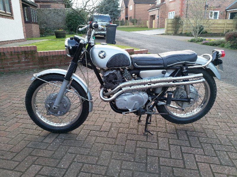

Well I think it is conclusive I must have a Honda 77 addiction as I have just purchased a CL77 to add to my 2 CBs. The bike was purchased on ebay and looked really good in the pictures. It was a runner, had been registered in the UK and even had been put through an MOT. So I committed to buy it, hired a van and drove about 5hrs to pick it up. As is usual the reality was quite different from the pictures, it does start up right away and most of the parts are there but everything does need work. I was tempted to walk away but given the commitment of driving all that way etc I went ahead with the purchase.
My intention had been to just run the bike for a while then restore at a later date but on inspection there were a few things requiring immediate attention. The front brake hardly seemed to be working, forks seemed very soft, air filters totally shot, some of the wiring looks very dodgy and really needs some silencing as currently running totally open pipes. So plenty to keep me occupied while hiding from the virus.
I am still thinking I will try and fix the immediate problems then look to do a full restoration at the end of the year but plans may change. A picture:

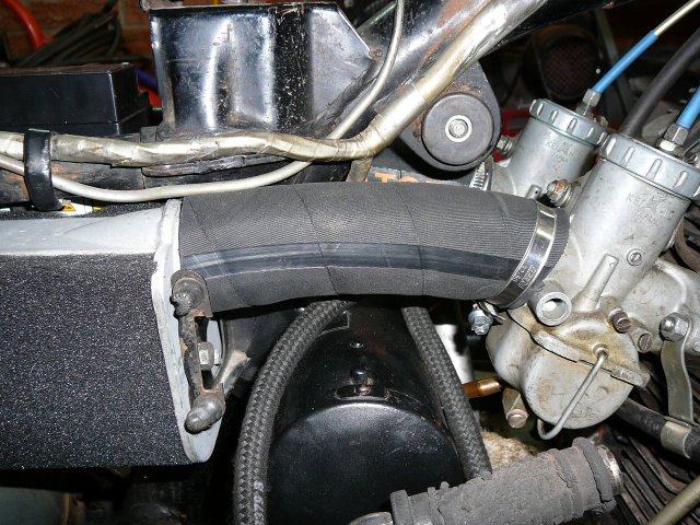

Air filters and link tubes were not useable. Neither seem to be available in the UK so the filters were rebuilt using ram air filter foam and as a temporary measure some radiator hose was used to join to the carbs. I will buy proper tubes in the future.
