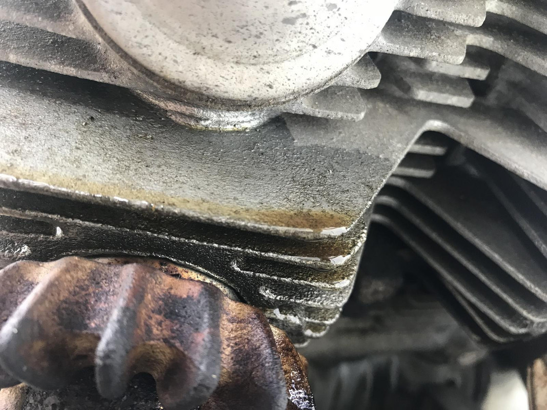

I also noticed oil dripping out of the right cylinder as seen in the pics below. It looks like it is coming out from behind the ignition somewhere and running to the front of the motor onto the exhaust.
