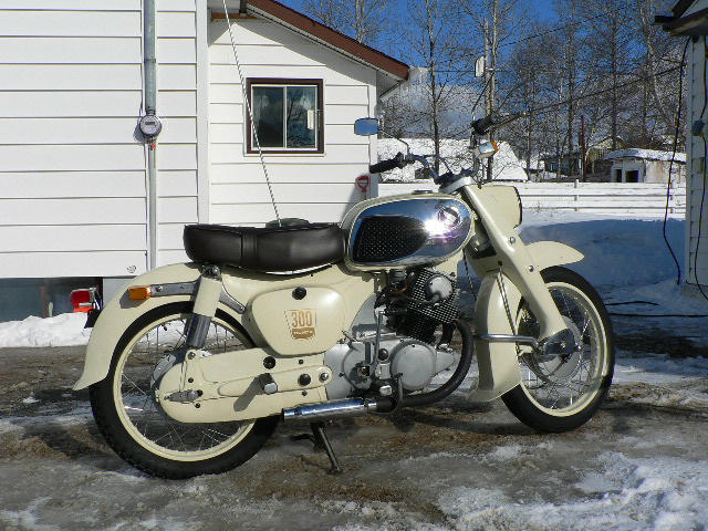

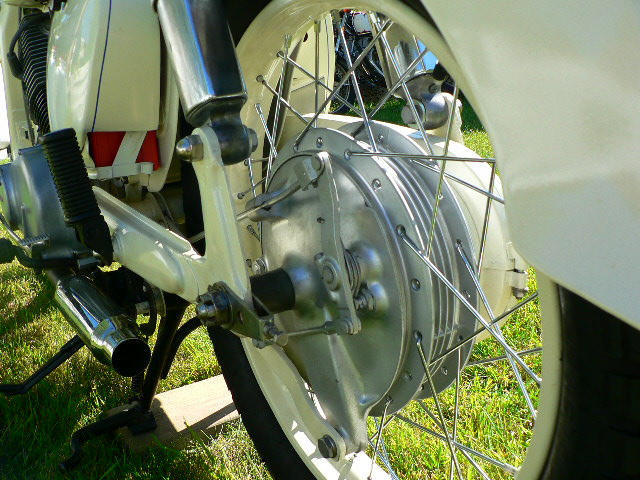

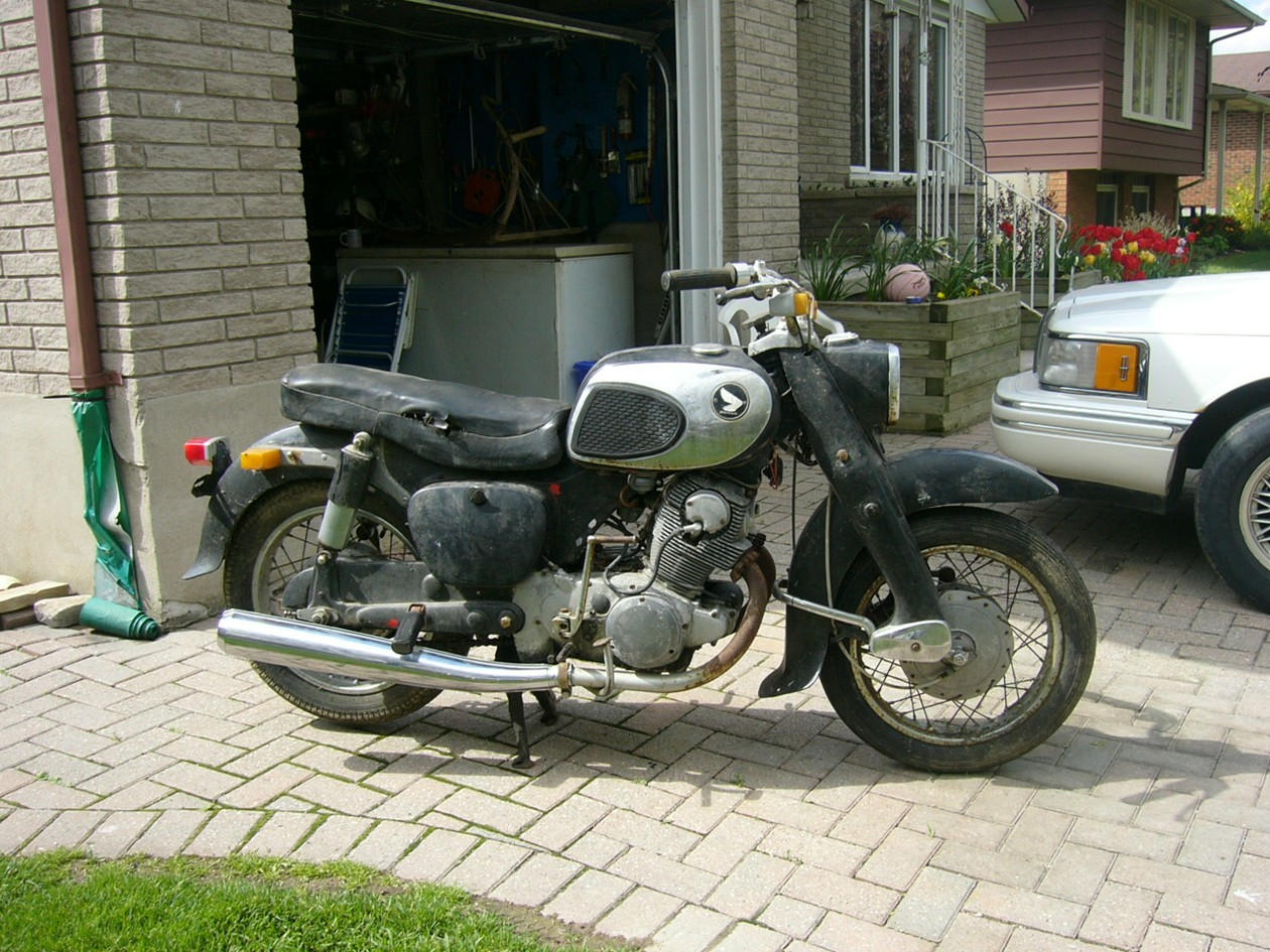

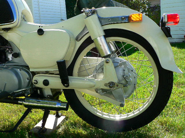

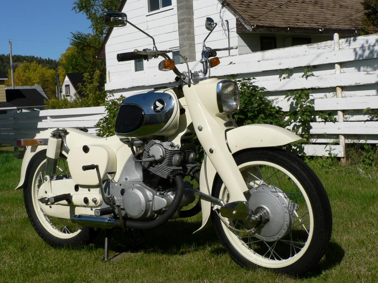

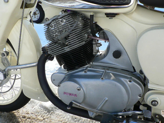

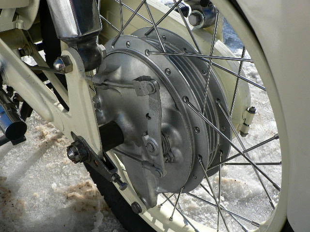

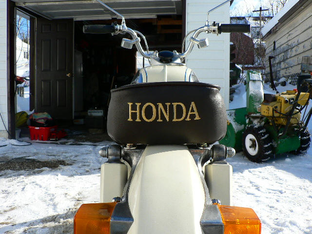

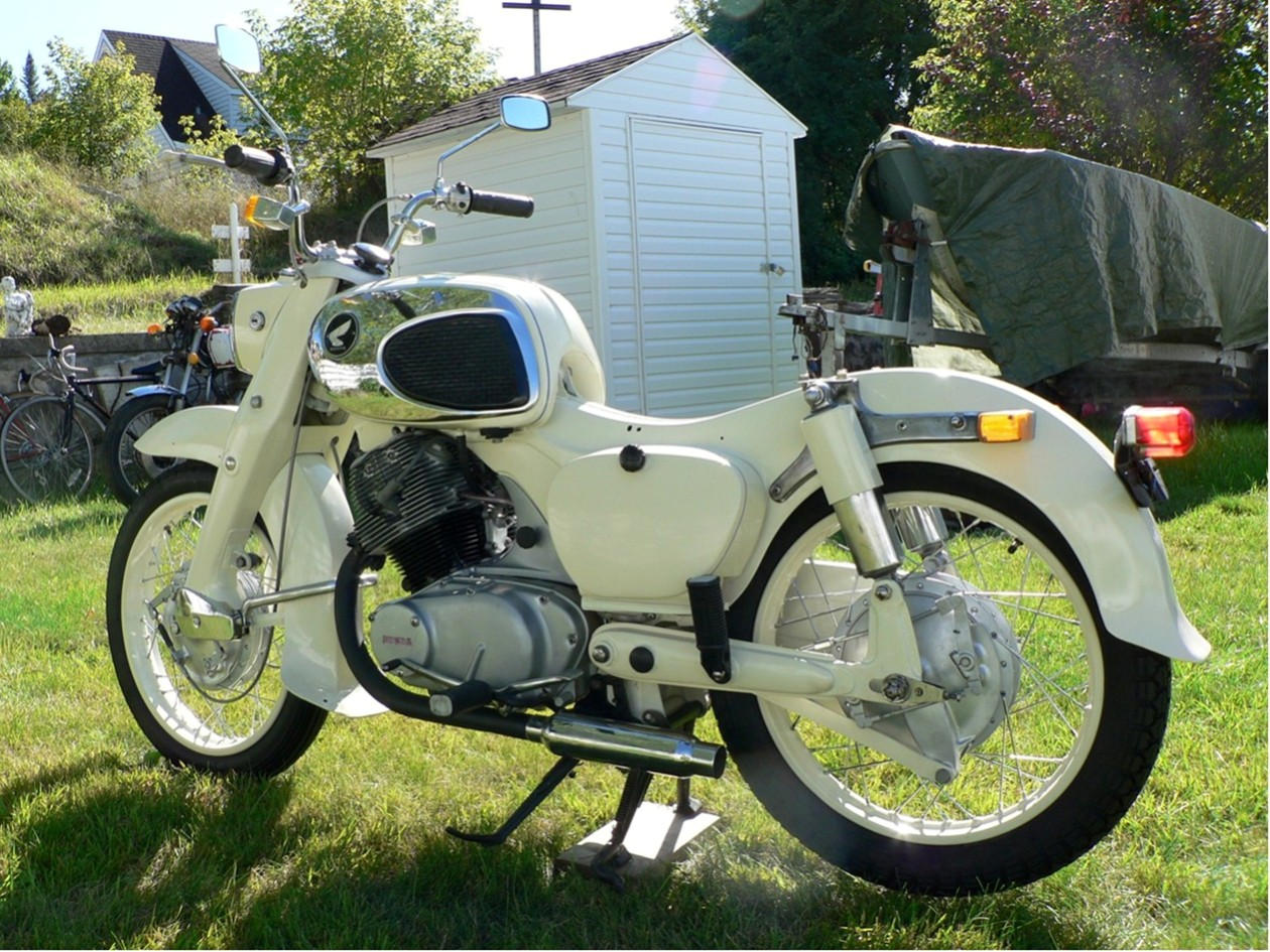

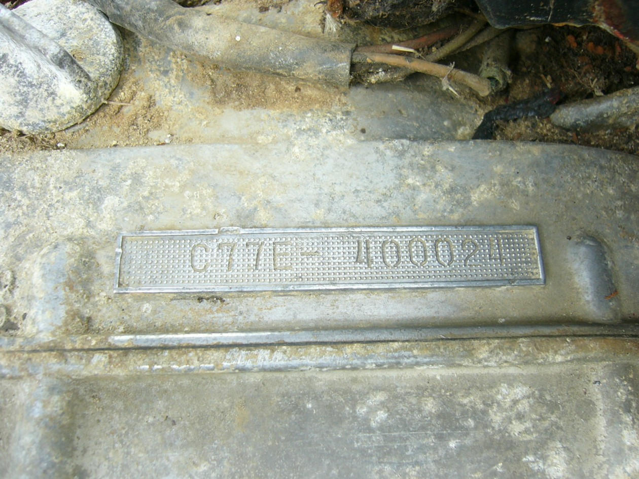

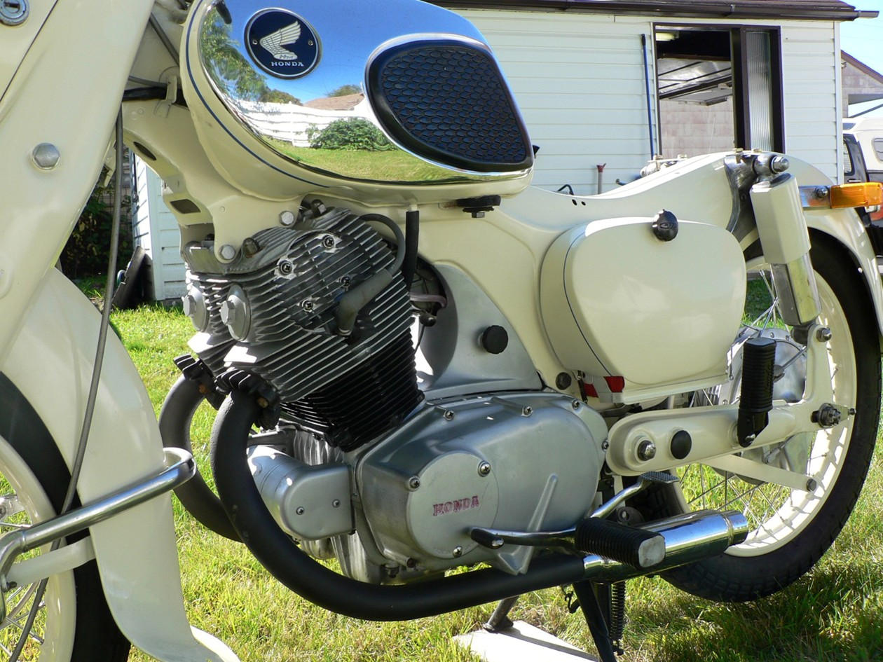

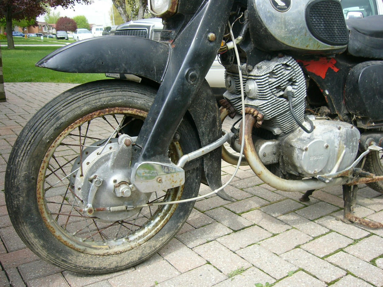

Found this in an overgrowen orchard covered with a tarp. All complete except lower chain guard and mufflers. Every bolt and nut was removed in the restoration process including engine and trans. Serial # C78- 40024 Engine, C77,E40024. Bead blasted frame and engine. All paint is from rattle can. Undercoated and finished with recreational white. Exhaust high temp black. ( am still looking for proper mufflers ) Built bike using super hawk running gear that I was not restoring. Had to make small mod's to do this. Have shortened seat 8 in. and recovered by NU-VU in Marathon Ontario. Paul did a wonderful job. You can contact him at 807-229-1681. Approx. under $700.00 CDN to restore.

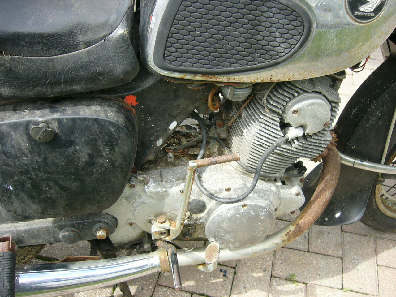

Another before
Another before
As bought before resto.
Dirty
Dirty
How am I going to clean this up?

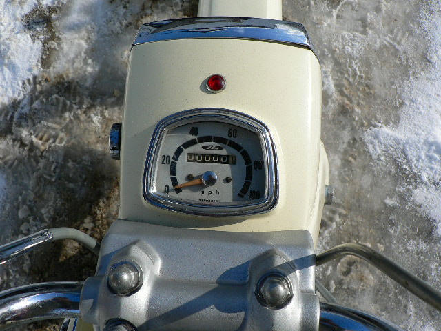

Restored

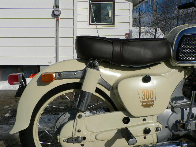

Post by jdbenly » Sat Feb 21, 2009 4:52 pm

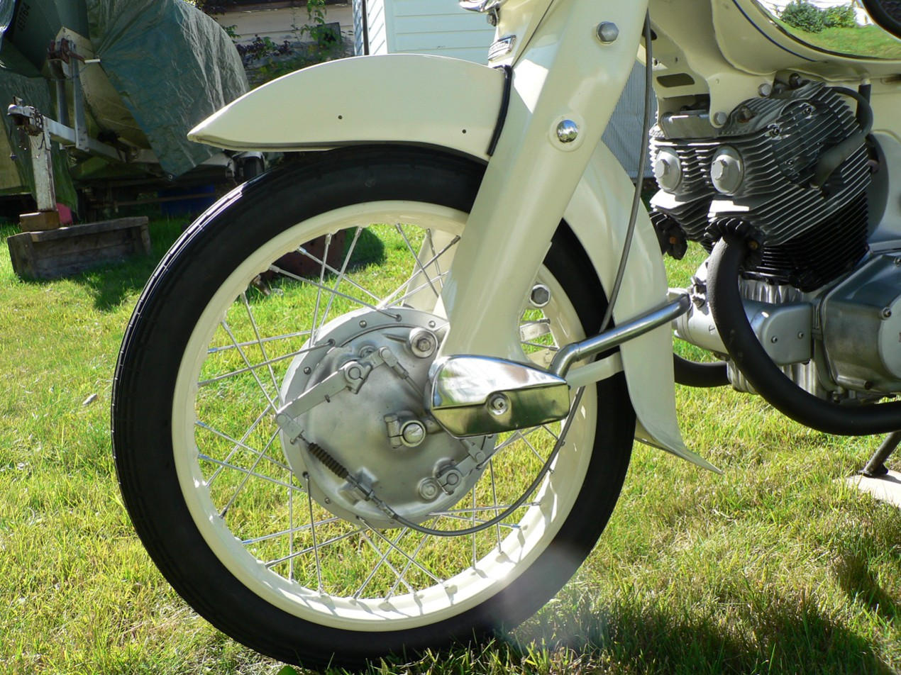

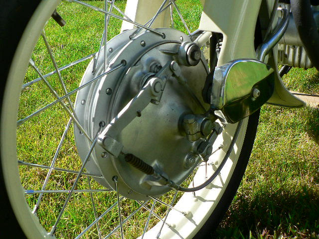

Restored

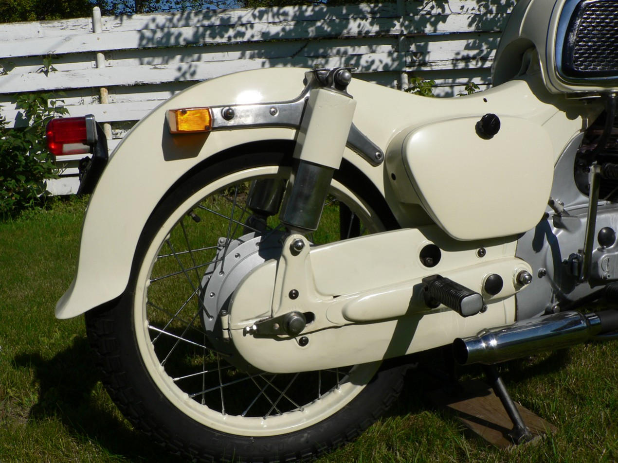

Post by jdbenly » Sat Feb 21, 2009 4:56 pm

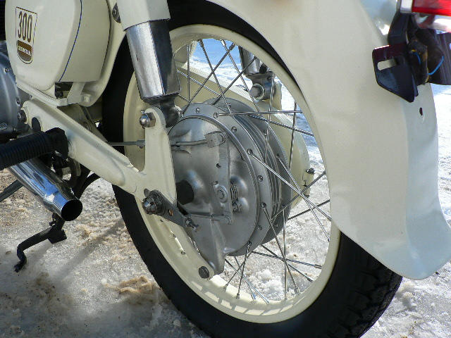

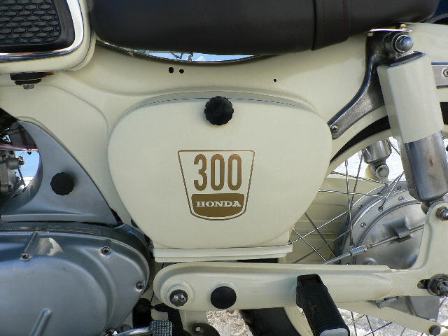

More pic's

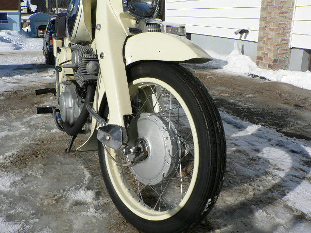

Post by jdbenly » Sat Feb 21, 2009 4:59 pm

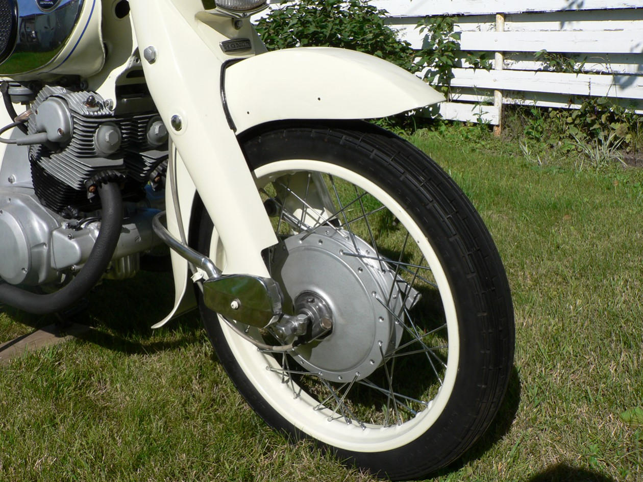

more

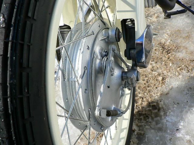

Post by jdbenly » Sat Feb 21, 2009 5:03 pm
more
