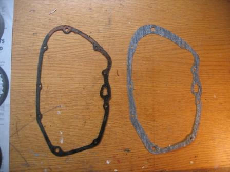

Removed the left side crankcase cover to take apart the clutch in an attempt to figure out if there was something obvious causing the clutch to drag slightly. Also wanted to get a good look at the oil filter as it seemed impossible to me to remove it and clean it and get the drive chain back on it without removing the case cover. I bought a gasket from an eBay retailer and note that the gasket doesn't follow the outline of the cover, it just gets wider where it needs to clear the bolt locations. Since this extra gasket material in contained inside the engine case, is there a concern that it disturbs the proper flow of oil at the bottom of the engine? Should I lay my old gasket on the new and trim it to the size of the original? I assume the new gasket was made this way because it's cheaper. I'm interested in the opinion of y'all whether I should be concerned about this or just throw it on and not worry about it.

Does anyone have an opinion about the question I posed concerning the crankcase cover gasket? I mean other than saying I should have bought a real Honda part, should I trim the damn thing or just install it?

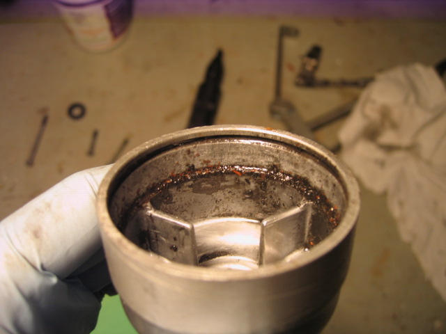

Here's the oil filter as removed from the bike.  Doesn't look too gunky.  I mean, I think.  I don't have any perspective on this other than other folks who have described this thing being really gunked up when they pulled it.

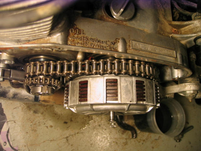

Looking for a reason the clutch drags.  Nothing obvious here.  Took it all apart, there's nothing obviously sticking.

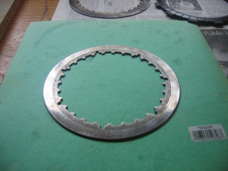

Thoroughly cleaned all the clutch plates, here's one to look at.  Checked for flatness on a sheet of glass, they're all flat.  Does this plate look OK or worn or what?
Post by davomoto » Wed Mar 04, 2009 6:31 pm
I'd just run it the way it is.

You show a 6 disc old style clutch.
The center hub should have 3 wires and it wasn't the best HONDA issued.
I can/will supply ya a machined 1966/1967 Cush Clutch which is the best ya can put in the engine.
