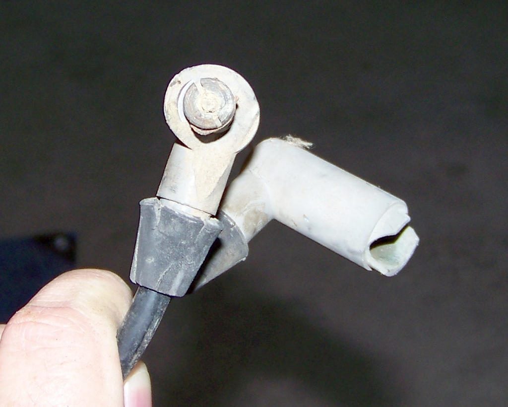

Still, in an optimistic mood, I began to consider what I’ll need to do to start it once things are moving. I’ll check the valves to ensure that they are all free, of course, and the carburetor will get a good cleaning. With that done, I’ll need the usual things: fuel, air, and spark. It’s the latter that I’m concerned about right now.
The spark plugs are, as mentioned before, out of the engine; one is broken, the other missing outright. So I need plugs. I’m not sure if the engine will run without the battery, which I’d naturally like to avoid purchasing until the bike is closer to rolling condition, but if I have to buy one, I will. Much of the wiring harness looks good, except, unfortunately, for the wire connected to the points, so I’ll have to work that out.
My real problem at present is the coil and plug wires, which are apparently a single unit, despite what Bill Silvers has to say here:
http://en.allexperts.com/q/Motorcycle-R ... am-305.htm
He is talking about a ’62 model in that post, whereas mine is a ’66 model, so that might make a difference; however, on the CMS website here:
http://www.cmsnl.com/honda-c77-dream_mo ... t/F29.html
the parts listing indicates that all CA77 models used the same coil and plug wires arrangement.
The coil tests out to 3.8 Ohms across the small wires, which I’m going to call close enough to the 4.5 Ohms Bill prescribes to make me willing to try it. I just have to do something about the plug wires, or at least the caps, which are pretty busted up.
Anyone have any suggestions?
