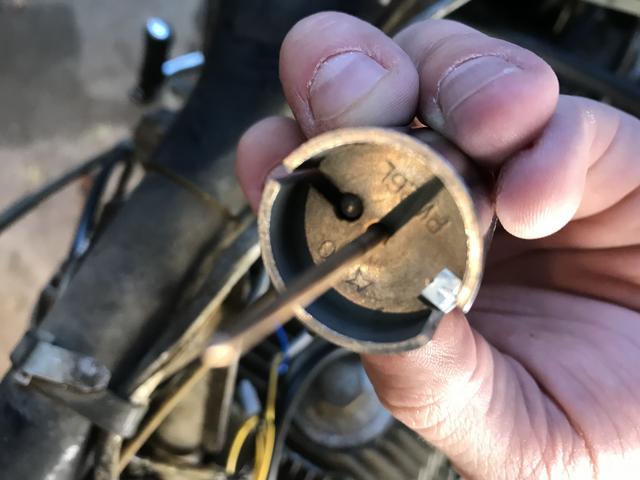

The slides should be marked with PW26L for the left and PW26R for the right

I took the slides out and they were in the correct order. PW26L was in the left carb and PW26R was in the right carb. I did notice that I was missing the gasket on the left carb that seals the top of the carb where the throttle cable comes in. So I put a new one in and it still has a sky high idle while the slides are all the way down. Time to do a little more research!
Thanks again to everyone that has contributed info. Slowly but surely I will get this thing going!
