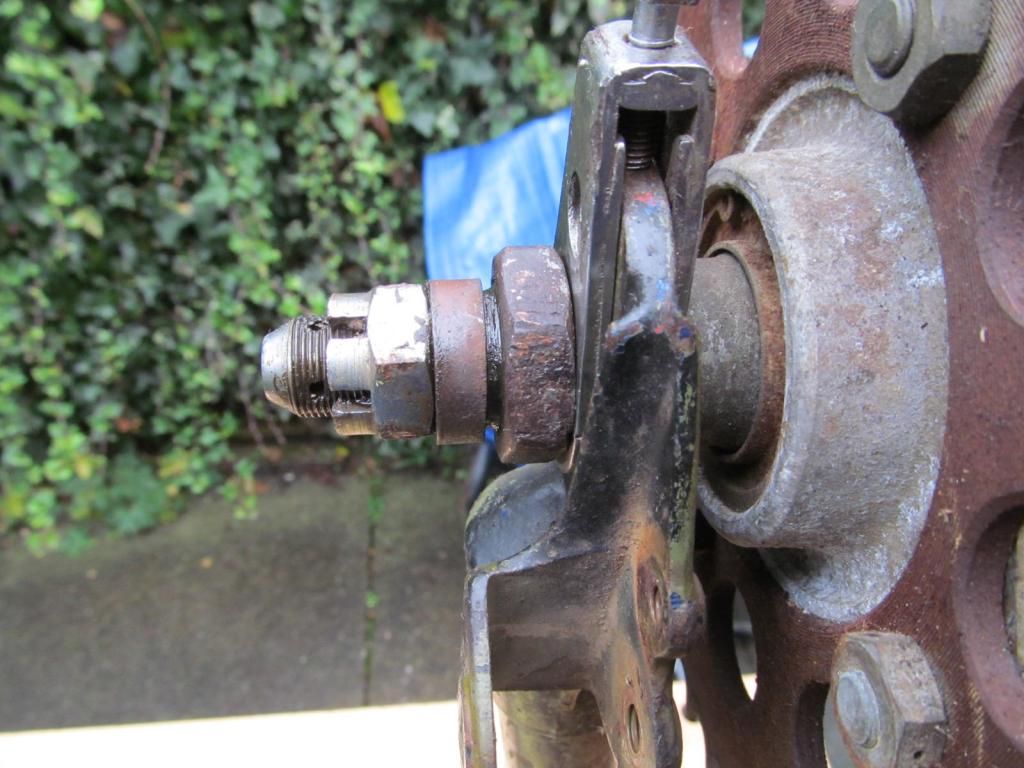

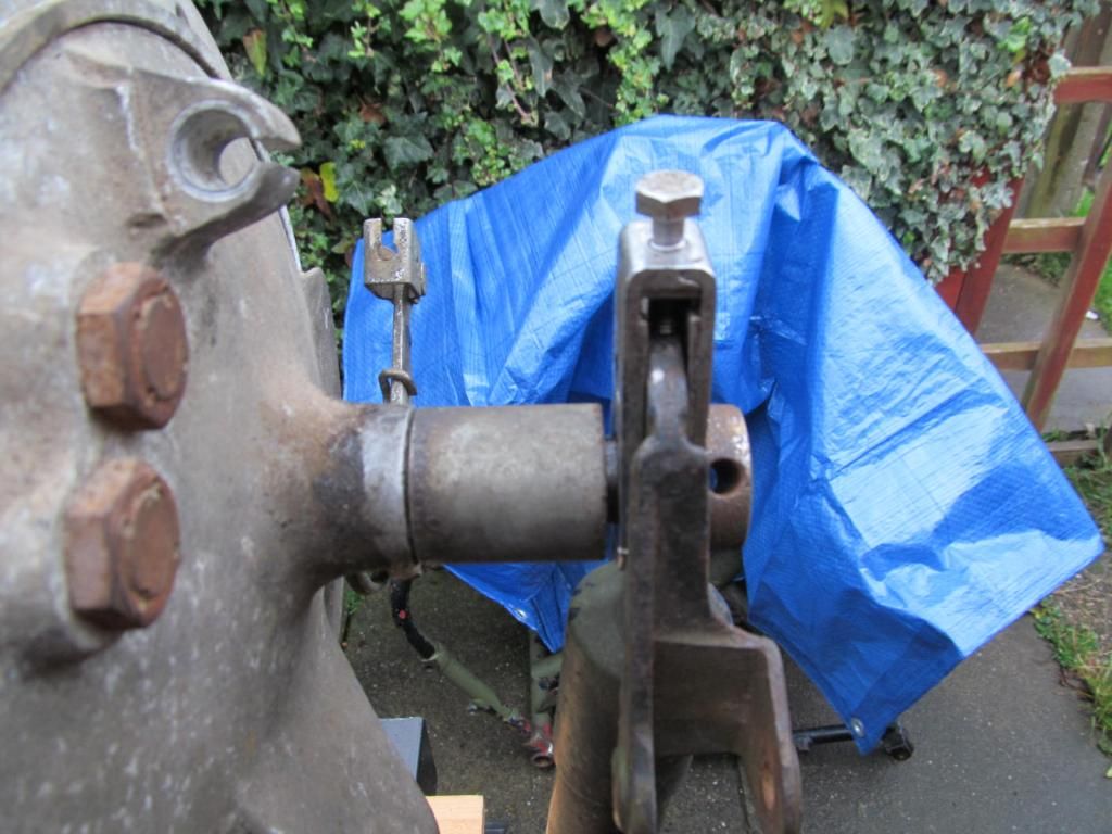

Checking the rear wheel parts on my 1964 CL72 and it seems to have an extra spacer

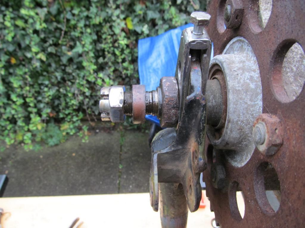

this is the other side before tightening

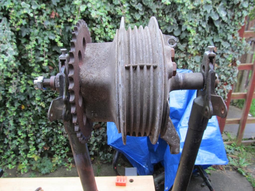

Overview of the assembly
After tightening the distance between the inner damper mounting and the hub is about the same +/_ 2mm which suggests the wheel is central.
After tightening the nut the spindle holes do not line up with the castle nut. I am aware the swing arm and wheel assembly was changed in 1964 prior to the later TLS brake change, are there 2 different length SLS rear spindles? and I have the wrong one.
