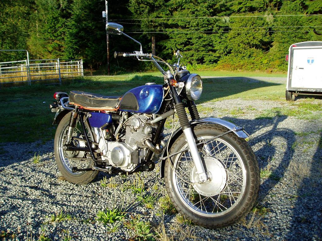

progress made
With the frame powder coated there was nothing standing in my way of putting this bike back together. so slowly and carefully I started the assembly process. Many parts till needed to be cleaned and painted. I put her together with the notion that we were not out to win points at shows but have a clean presentable driver to sport the rest of the season on. So this is what I've ended up with so far.
Eng.
Used a good clean cylinder block from the parts pile along with two stock pistons in great shape. The micrometer showed all parts within acceptable limits. I did a static fluid test on the valves and found one seep so I touched it up with a bit of lap compound and a donor valve and got four good tight valves. The entire engine was bead blasted and assembled.
Trans.
Had to replace a couple broken gears and the first gear bushing. The gears were already x'ed so I didn't have to deal with that.
Winkers,
I was going to piece-meal a period correct assembly together but decided that the ebay kit complete with switch and flasher unit for $60 US would be more cost effective than doing the pieces. I lucked out when I installed another wire harness off a parts 67cl and it had winker wires in it, so I was able to use some of them making assembly even easier. Sure is nice having them rather than the arm.
Paint
I did use some rattle can paint with clear coat (shame on me I know) but I will replace some of it during the paint learning curve. I now have an HVLP gun and will learn to use it this winter.
Is it perfect? Not by a long shot. I still have many little projects to accomplish here. Brake hubs, spokes, seat cover, and paint my year correct tank with a suitable shade of blue.
But at least I can ride her for the rest of the season and enjoy the fruits of my labor.
A heart felt thank you to Davomoto, GMan, Fast Fred for your contribution of parts and info.
BTW,,, When I hooked up the gas line and kicked her over she fired on the second kick, so I warmed her up and rode a bit to seat the rings, then went another twenty miles that day. We've got 140 miles under the seat now and looking forward to doing the oyster run in three weeks. Hope to see you local folks there. RW

RW
That's a really nice looking bike. I wish that I'd got one in close to that state. I have several projects all in pieces and really need to get something together so that I can enjoy the ride, like you. That later color scheme works well and I am glad to see that you have ditched that awful muffler.
I hope to have something shiny but rideable ready next spring. The summer has almost run out here in the UK.
Enjoy that bike!
Enjoy that bike!
