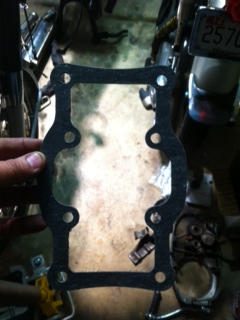

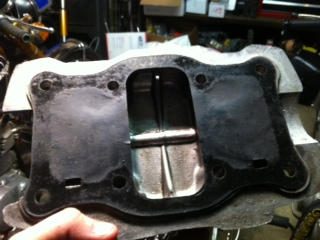

Is this a gasket in the second picture?
Seems like a hard plastic piece, that won't come off and I am scared to try.
Should I:
1. Slap it back on, lock it down to 15 pounds and forget it.
2. Remove it and use the gasket in the first picture?
3. Leave it on, and put the new gasket on top of it?
4. None of the above.

Reuse it and torque ta 22fp.
Don't remove any parts which are still stuck. ...........lm

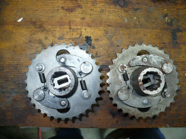

Re: Pic of the legendary neoprene on the advance weights...
LOUD MOUSE wrote:That looks like a DREAM sprocket. ???????????????
I'd say it's a Dream sprocket.
HT
It is a DREAM sprocket but it's from my Dream engine, not the bike the original poster is working on.  I merely posted a pic of it because of all the talk recently about the neoprene in the advance units on these old bikes.  Figured it might be nice to see what the hell all the talk is about.  Not enough PICTURES posted in this place!
I don't recommend ya use it in your engine.
It's a small bit not over the entire outside of the part.
If ya can lift it and sort of allow it to snap back and don't hear a metallic sound (sort of a CLUNK) ya are OK. ......lm
rzgkane wrote:I looked at the advance unit on the spare motor I have and I found that the neoprene was indeed there, although half of each piece was missing from both of the weights. See below:
