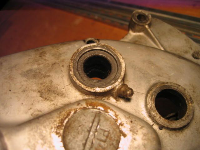

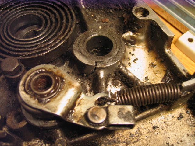

So while preparing to clean the cover, after removing some of the hardened gunk I noticed a crack around a gear hole. I've read these covers often exhibit cracking around the kickstart lever hole especially when lubrication has been inadequate. This crack is not at the kickstart lever hole but the gear hole next to it. I've included photos. I don't know if this crack is severe enough to warrant looking for a different cover to replace it...any of you guys have an opinion about that? The crack is not visible on the outside of the cover, it hasn't migrated that far.
Can't see it on the outside.

How do you get this stuff apart?  You can see the crack in this shot.

I'd clean it up really well, and bring it to a good welder. The bushing will have to be removed before welding, as it is bakeolite, and the heat from welding will destroy it. It might not be a bad idea to have a machinist make a new bushing out of brass.

That part is cast metal and I'd not worry about that crack/line. Have ya cleaned the area to be sure it's a crack and not a casting line?. ...........lm

This has to be the weakest spot on the CB72/CB77. I think 8 out of 10 of these I've seen are broken! There was a friend of mine up here that was drilling them out and pressing in a better bushing.

Ed, I haven't yet cleaned the cover but I'm nearly positive it's a crack. There are very thin casting lines on the outside of the case that could be confused with assuming the crack has made it all the way through the cover, but I don't think so.
