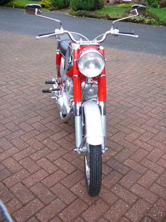

The bike is getting close to completion though there were some major items I did not have. Although I had silencers and downpipes they were in poor condition so I have been waiting for David Silvers to get stock of their reproduction pipes and silencers. I now have them, some problems fitting the downpipes but now in place.
For the seat I do have a seat pan but it is in very poor condition and I am not sure whether it is genuine or not. Looking at all the options I was reluctant to buy from abroad and although there are people making good quality seats here to get one with the metal trim is expensive. What I found was that Wemoto did a seat with trim and Honda printing on the back for about £100. The quality is not great but good value for a useable seat and I can look at something better in the longer term.
The registration was obtained without problems with the nova and a dating certificate from the VJMCC.
There are still some parts I do not have such as the rear mud flap but nothing essential.
I am pretty sure that I have a problem with the charging system so I need to get to the bottom of that then do some test runs as no doubt there will be some teething problems though the weather is not being helpful. At the moment on static testing the bike starts up immediately but does struggle to run on choke then seems OK once there is some heat in the engine.
Particular thanks to DJM, Graham Curtis, Gordon Brown and LM for help and guidance along the way.
Greg

Thanks Muddy, Geoff, though my suggestion that it was nearly finished may have been premature as the charging problem appears to be the alternator rather than anything to do with my wiring or the new reg/rectifier.
