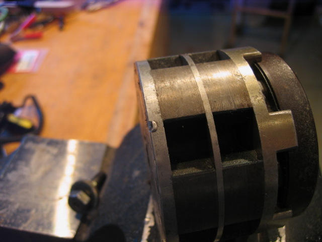

I was examining the stator and it looked like the metal surfaces were grooved, non-uniformly in some places. So I looked at the rotor and noticed that there is a little gouged-out metal on the rim...I'm guessing someone inadvisedly jammed a screwdriver in there for some poorly thought out reason and did this. I've attached a photo showing the rotor edge. So I will grind and smooth this off.
Which brings up another question...since I have all these parts out, should I freshen up the "business end" surfaces of the rotor and stator? Should I apply a little steel wool and elbow grease or perhaps something more heavy duty?

If ya like ya can dress up the parts but I don't recommend steel wool as the rotor is magnetic!!!!!!!
Ya can check the stater coils for looseness and if any are loose (move at all) ya can use a punch to bend down the thin steel flap sort of thing on each end. ..................lm

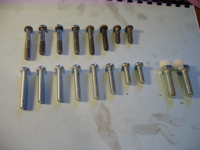

Continued on over to Tacoma Screw Products as I couldn't abide the thought of wrenching all these gouged up crankcase fasteners back onto the bike. Also looking for some bolts to hold the seat down until I can get my hands on some proper shouldered bolts. I had my seat with me so the seat bolts were no problem...I bought nylon spacers so they at least approximate the stock bolts. Since there're five different fasteners on the crankcase cover, I made detailed notes where they all go. Then I dumped the whole handful into the Tacoma Screw guy's hand and he promptly went back and came out with all the bolts I need. Total bill with tax....$4.17. This place is where the big-time contractors and various jobbers go but they give great service for even the small fry like me. So any of you guys in the Puget Sound area that need fasteners, save yourself the trouble of searching all over the internet for this stuff because Tacoma Screw is evidently the old Honda restorer's best friend.
Here's a pic of the old and new fasteners.
