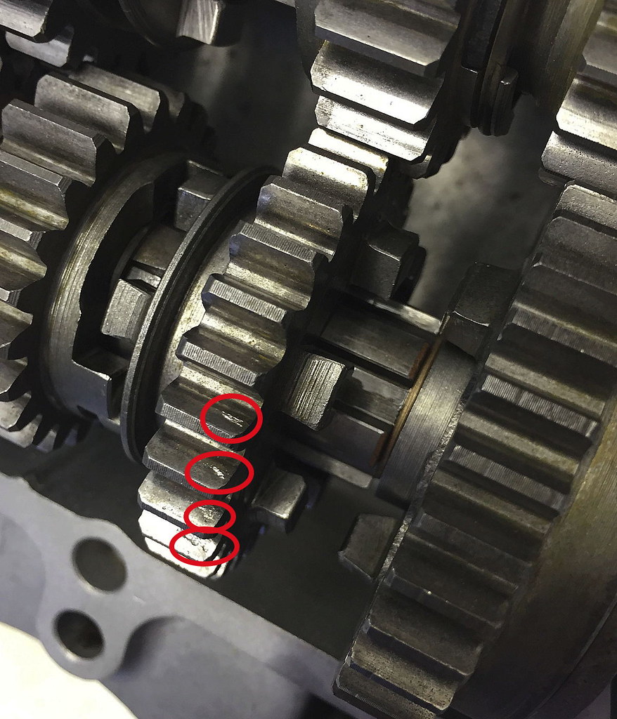

I feel like an idiot, but I've been staring at this photo trying to see where the damaged gear is and I just cannot find it. Could you point it out?
Thanks for your detailed posts. You go far beyond what most of us are capable of.

Here you go. The damage is on the surface of the gear teeth. This is not the worst gear but the pitting here could eventually turn into cracks from which the gear tooth would break up.
Seadog wrote:I feel like an idiot, but I've been staring at this photo trying to see where the damaged gear is and I just find it. Could you point it out?G-Man wrote:
