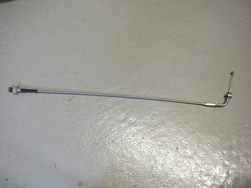

For the throttle cable I made a new top part using the existing fittings
A totally new clutch cable was made, the outer for the speedo cable was replaced using the existing fittings and inner. For the rear brake the later model has the same outer length but the inner is longer to fit the longer operating arm. Here the existing inner was OK so I was able to reuse with another outer by removing the rear nipple, swapping the inner over and replacing the nipple.
