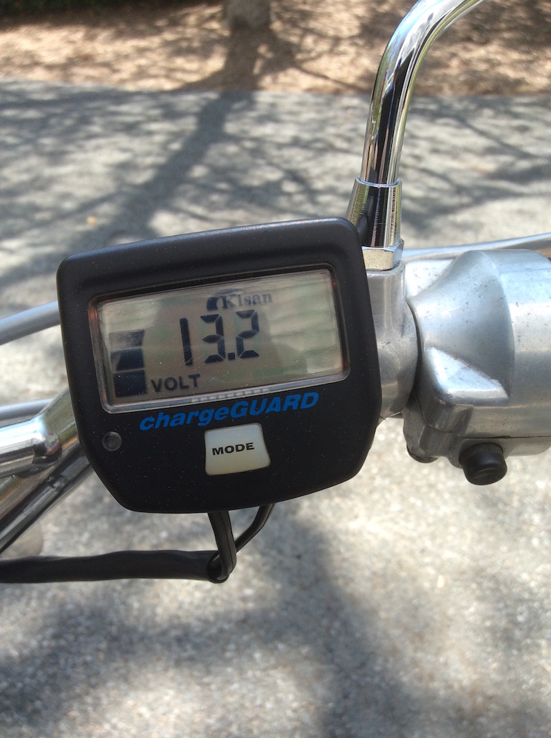

My first reaction to your photo was "that's nasty!", but overlooking the rust, etc., it's really not. It was a nice installation and must have looked good in the day. Will you keep it, or repair/replace the headlight bucket?
G-Man wrote:I like the look of that. On my 1961 CB72 someone had neatly grafted a Lucas ammeter into the headlamp for a similar purpose.
Post by LOUD MOUSE » Tue May 24, 2016 2:18 pm
I'd say that will make for a better safer installation. ................lm
Seadog wrote:Happy to help. I'd help with parts sales too, if you have a good right side muffler....
I was just looking at the on-line manual for the ChargeGuard and see that they've improved the current sensor. It no longer has the copper tabs. I think that's a good thing.
LOUD MOUSE wrote:Thanks.
I'll collect the monies from parts sales and get one.
Looks like a really easy test of the charge system. ..................lm

The Kohler R/R seems to be working okay. At idle, I'm at 13.+ volts. It bounces around and rises on rev. I checked the temperature on both sides of the Kohler unit with an infrared thermometer and it was in the mid 70s F. Feels cool to the touch, even after a long idle. The seat and side covers were off, however. Air temp was about 70 F.
