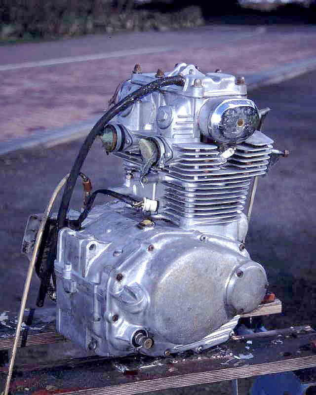

Do you happen to have any pics of parts cleaned by this method handy?
Posts: 5678
Post by G-Man » Mon Dec 14, 2009 4:34 pm
Brewsky
Only example I have to hand - the engine had spent quite a while outdoors.

Post by brewsky » Mon Dec 14, 2009 6:25 pm
Thanks, G-Man, now I have another tool to buy!

I can vouch for the effectiveness of G's suggestion, Brew; I once had a Karcher pressure washer that came with the grit-blasting kit of which G speaks. It had a bucket of black grit with it and left my 15-year-old brick wall looking like new! Pretty messy, but what a result. Grit would be a tad aggressive on alloy, but dry building sand should be ideal. Test it out on an old casing, or similar, first.
Wear oilskins, wellies & goggles -- or a full wetsuit!
