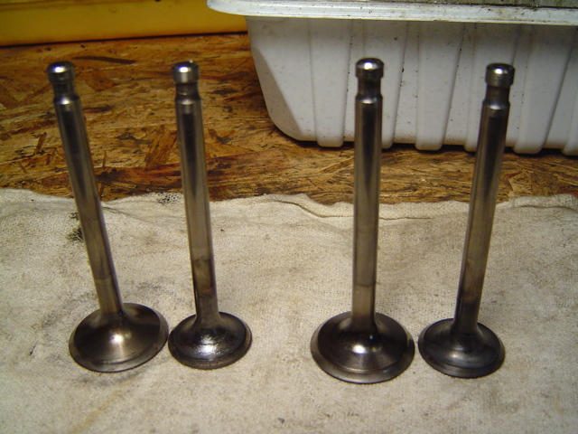

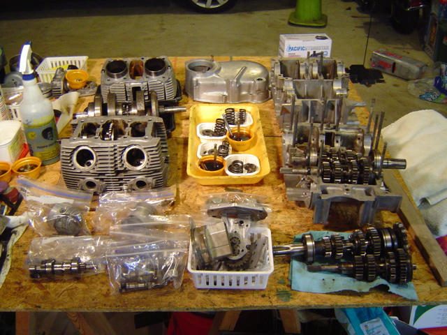

Ok, I have all the major engine components out and cleaned and am ready to start ordering parts, gaskets/seals, have some minor machine shop work done, etc., but I have a couple of questions.

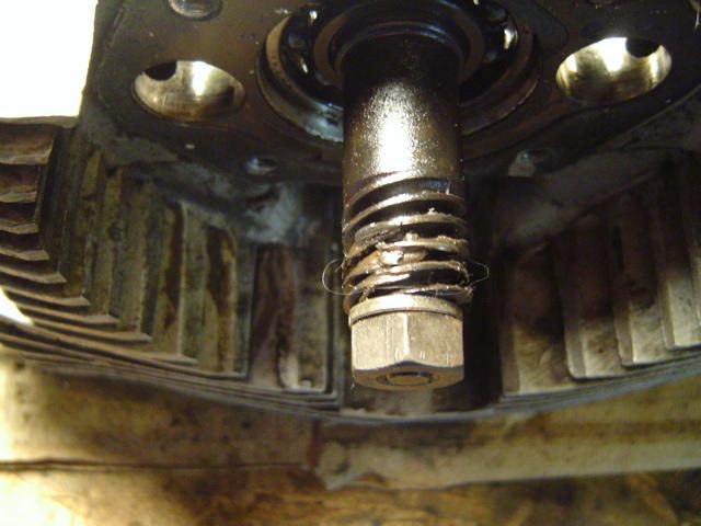

2. I earlier posted photos of the rocker arms and tappet adjusting screws, do these look ok? is there excessive wear rocker arm pads and are the tappet screws too "Flat".

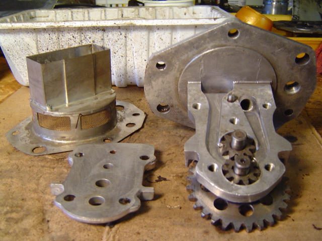

3. Is the oil pump in good shape? all the tolerances were good according to specs for the gears, etc.

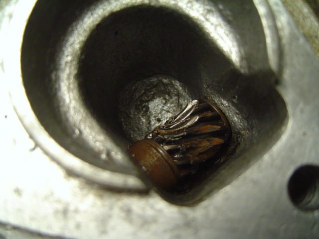

I will take the cylinder head to a local machine shop for dipping, valve seat check and lapping the valves, and to hone the cylinders. One major component I will need to replace is the left camshaft as the tach gear has stripped the end of the camshaft and totally chewed the gear in the left side cover tach gear (see Photos)

Tach gear, Left side cover
Gear on end of Left camshaft, stripped gear

Thanks lm, BTW can you answer the questions I had on the rocker arms and tappet adjusting screws i mentioned previously?
Greatly appreciate it.
Post by LOUD MOUSE » Thu Feb 16, 2012 3:36 pm
Always tough to advise on parts such as this.
The adjusters can be DOMED again with 400/600 grit on a flat sanding block pulled over in a arch.
Sorry but cant tell on the rockers. .........................lm
