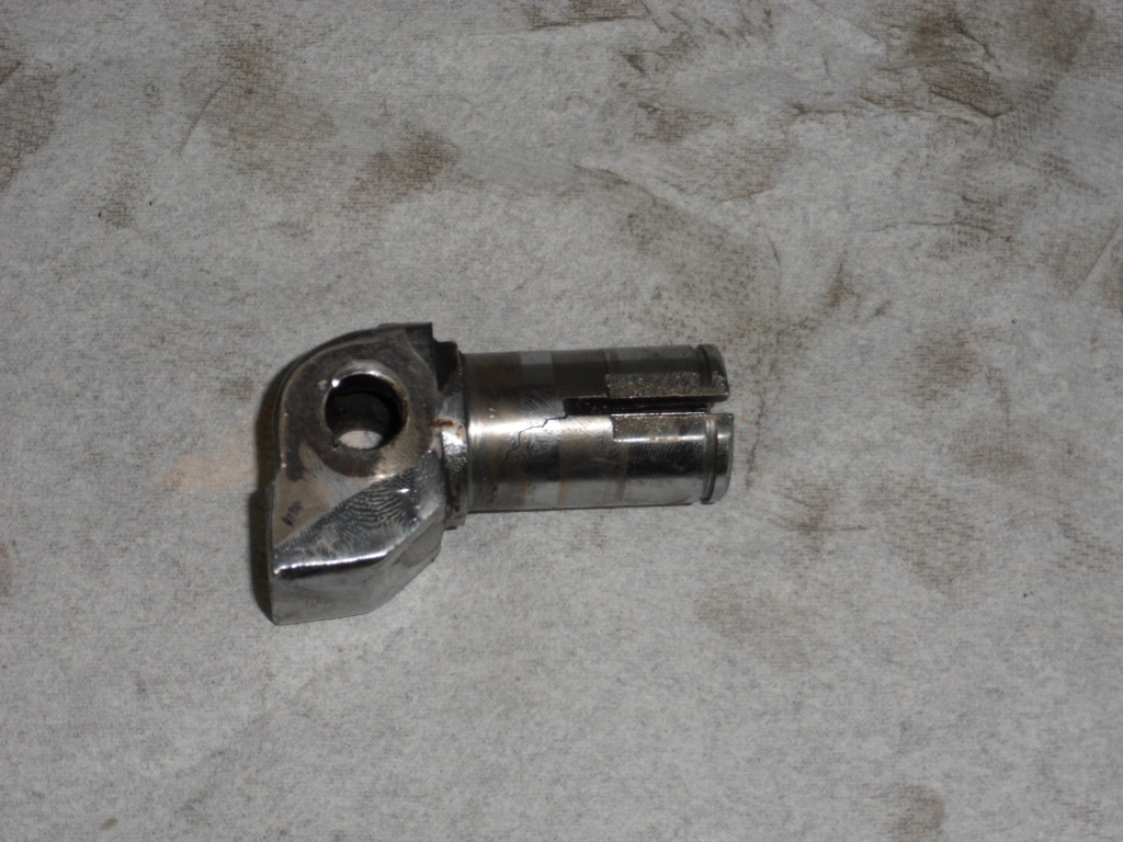

Also, I managed to crack the kick starter joint. I am hoping that it can be professionally welded but I've attached a pic for any and all suggestions. Anybody know where ya can get a replacement?
As usual, thanks in advance!!

Yes, the carbs and filters can easliy have been the culprit! There shoud be adjusters for the cables at the wheel end of the cables as well, have you adjusted those? I dont think welding is a good solution for the kicker joint. Post in the parts wanted section on this site, and scour Ebay as well. It is common for them to crack.
