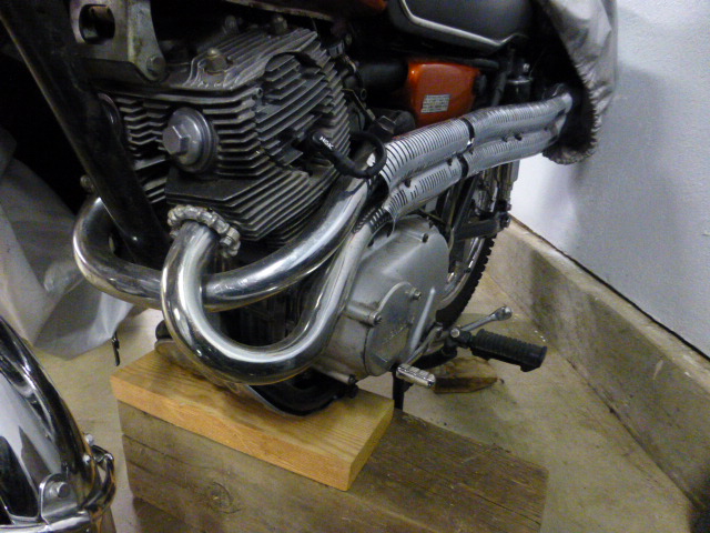

Not to my knowledge, it's what was on the bike when I got it and it looked as if everything was original. what is the difference between the two? Figured I'd include a better picture for reference.

Post by LOUD MOUSE » Sat Nov 18, 2017 7:31 pm
Thanks for the pic.
I can see much better that it is a 305.
Thanks. ..........lm
