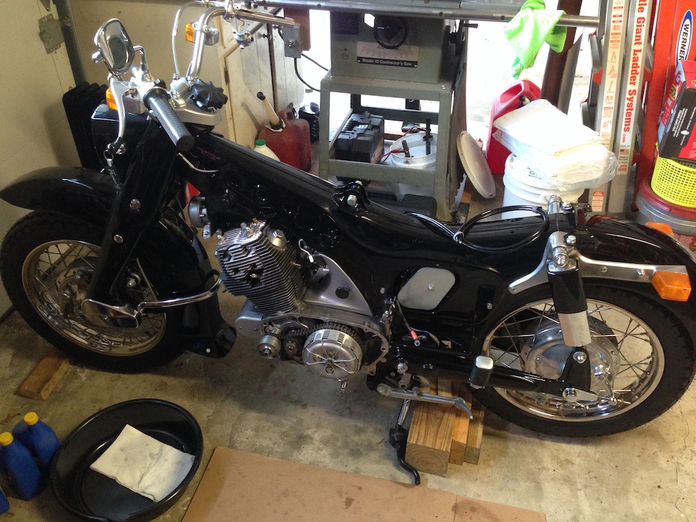

- Current State.jpg (322.24 KiB) Viewed 2897 times
Worked mostly on wiring today. I just hooked up a battery (without the starter motor wire) and tested everything. Winkers, high beam, horn, speedo light and neutral light worked. The only faults were with the headlight's low beam, the tail light and starter solenoid. The tail light turned out to be a bad ground, but the headlight low beam is a small mystery that I'll resolve tomorrow. I'm guessing it's a red wire bullet connector that looked a bit dodgy when I made the connection. I would have thought that the starter solenoid should have clicked, but it was silent. Maybe a bad ground. I'll test it tomorrow.
I'm a little perplexed that I could not find any mounting points for the wiring harness inside the frame and it just hangs there. Maybe I missed something. I could find no references on this site or the Internet.
