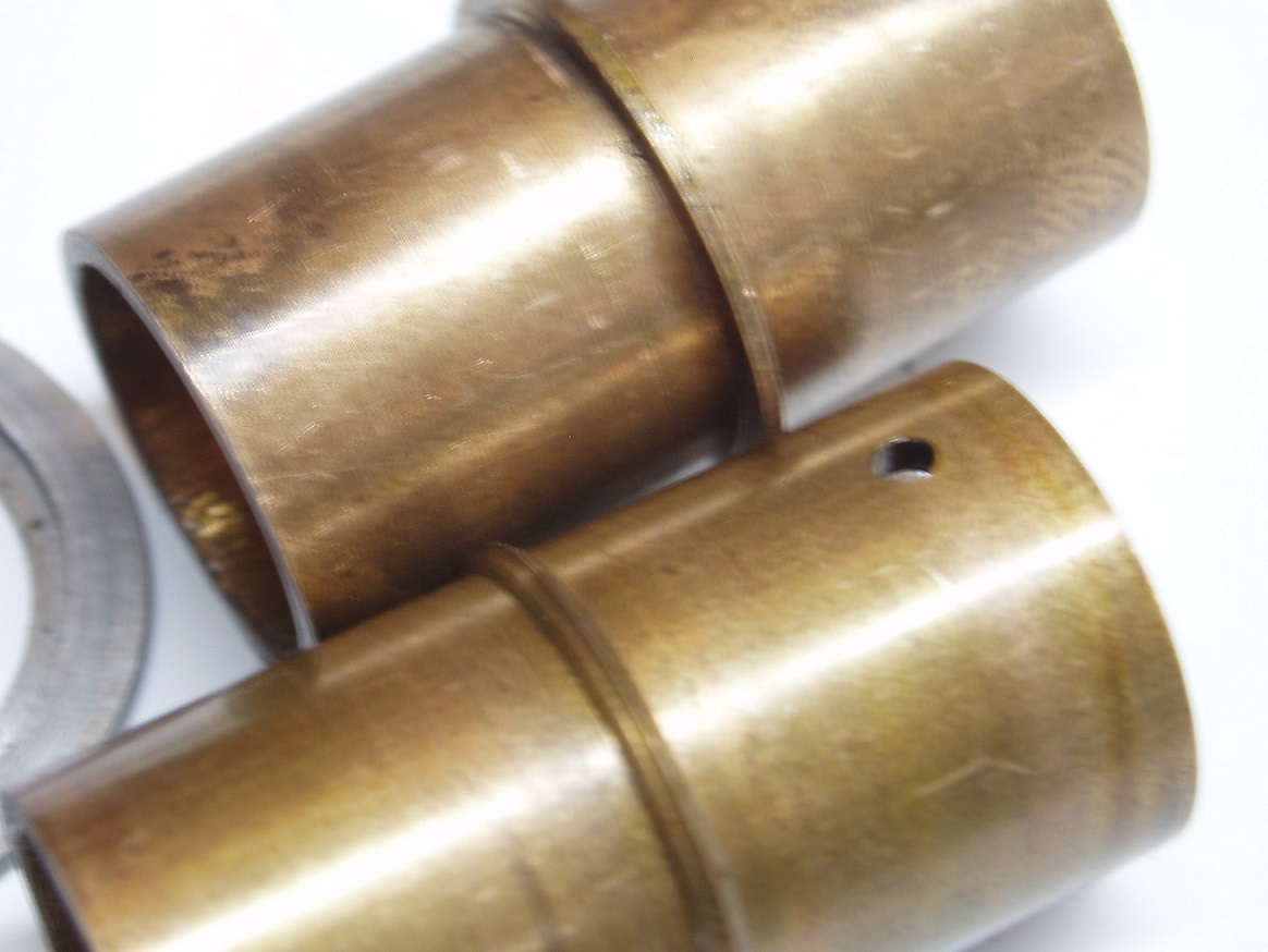

So here is my method of (hopefully)curing the wear issue with the 18mm bush in the gearbox.
The following pictures show the worn bush next to a new one, the new bush with a stepped shim, and the assembly in place, ish.
It would seem that the bush shoulder wears as there is a very small contact patch with the adjacent shaft, due to the chamfer on the inside of that shaft. Now there isn't any end thrust due to the gearbox operation, so how about the oilway in the bush being helical causes a small axial load due to the oil flowing in it and the rotation imparted from the shaft and gear that it supports. It need only be a small force, but over a high mileage...?
So I've had a stepped washer made up to accept the bush shoulder which doubles as a shim to remove unwanted endfloat in the shaft. The bush shoulder gets a better contact patch and is prevented from contacting the shaft.
Should last forever now....
