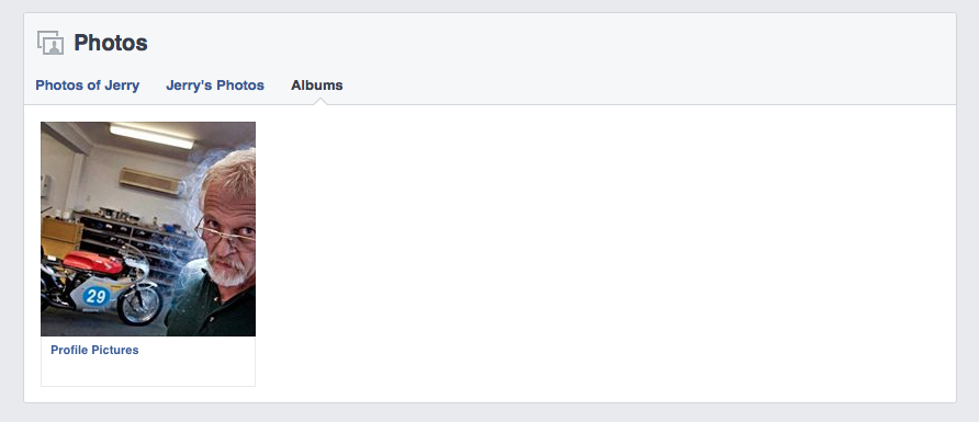

I cannot see any albums on the Jerry Kooistra page. All I get is this : your profile with just one picture of a handsome looking bloke with an interesting Honda behind him....
