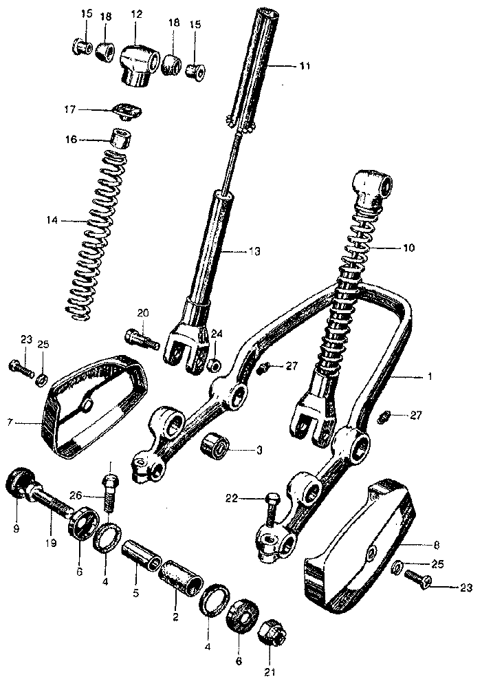

Does anyone have a source for 51215-250-000, the front shock mounting lower bushing? I checked with Ohio Cycle, part listed but out of stock.

the front brake stay bushing can be used as a replacement for that bushing. as the stay bushes don't seem to wear out like the shock mount bush I have used them a few times as a fix when I could not get the correct one. helps to a have a pretty deep inventory of parted out bikes, those brake stays are easy to find.
