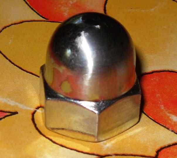

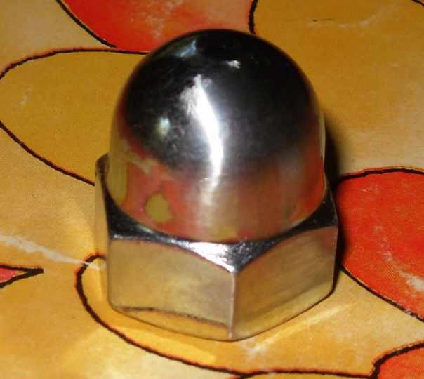

so when you polish stainless out, how does it look? Does it shine and is similiar to chrome in its look?

Post by cadman » Mon Apr 22, 2013 11:03 am
Here's a pic of a stainless acorn nut that holds the shock. I polished it and ran a die over the shock mount so it wold thread on. Stainless will polish and be very close to chrome - It won't have quite the "snap" that chrome has. There is a compound specifically for stainless (green) but regular will work okay.
